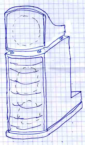

Hi Danny and all Audio Circle members.
I know this subject was mentioned/discussed sometime ago,
but I would like to know if my reasoning makes sense.
The spikes at the bottom of a loudspeaker are to avoid vibrations to be transmitted to the floor and/or to the speakers from other sources of vibration.
Right ?
Then, why this set up (Below) would not work or would not efficiently diminish the vibrations from the bottom subwoofer to the upper coaxial driver.
If it works for the floor, why would it not work for the coaxial on top ?
Or, of it won’t work or won’t do much to diminish the transmission of vibrations, can it have negative effects on the sound of the coaxial driver ?

Guy, spikes are used to couple, not decouple/isolate.
I think that making the top driver baffle solid with the bottom subs would of course couple more effectively than spikes.
I do wonder though, in situations where speakers are spiked to the floor, would it be better to bolt them down to the floor? I don't know. I've never heard of anyone trying or talking about that.
Trying to bolt the speakers to the concrete or joists beneath them would be not that hard in comparison to building an entire dedicated room, or some of the other extreme measures we take for better sound :)
Steve.

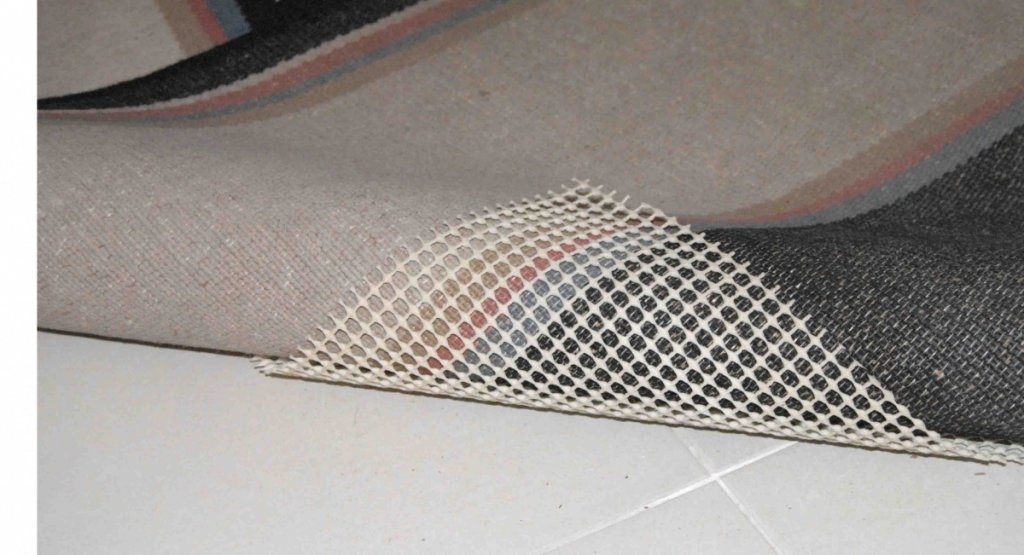

Hey Guy do you have carpet over the concrete floor ? If so consider Herbies products right here on AC.

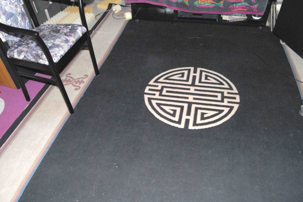

charles
Hi Charles and all Audio Circle members.
Yes a have a thin carpet (See picture below) and an IKEA under carpet
on a ceramic floor and with 12" of armored concrete underneath.
I just had a look at Herbies website, nice products.
I might buy some of those products, of course, after robbing a bank.
Nice products, look well designed and made, but a little on the expensive side.
Thanks for the link.

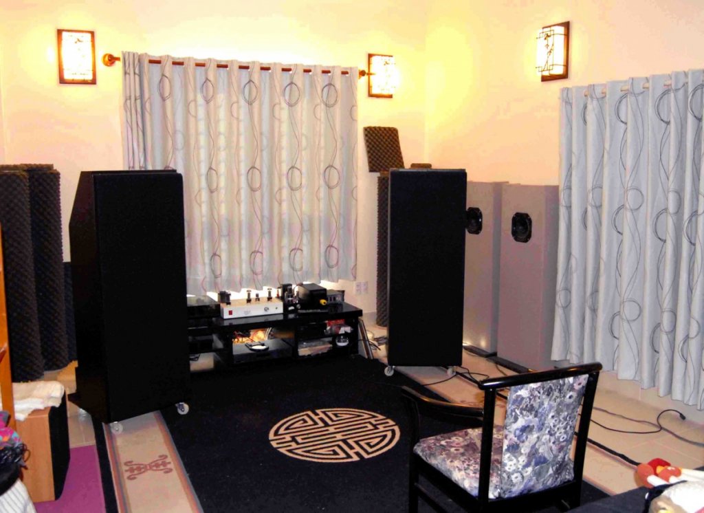

Guy 13
Re: Spikes or no spikes ?
« Reply #10 on: 20 Dec 2012, 09:37 am »
Hi all Audio Circle members.
Yes, I got the go ahead from my wife, after a little clean up.
Here it is and please no comments on the wheels,
at 64 years old, I cannot lift all by myself the 150 pounds each V1.
Once I have found all the ideal parameters,
I will either install spikes or something else.
By the way, why Danny stayed quiet and did not comment on this subject?
It's not the first time he does that, he let other people comment... For him.
I have GR Research speakers bought from him, therefore, I wouild like to have his opinion on his speakers, even if they are modified.

Danny Richie
« Reply #18 on: 20 Dec 2012, 10:01 pm »
I needed some time to get to it.
Speakers should be coupled to the floor with some type of spikes to isolate the weight of the speakers to those small points. This keeps the speakers still and anchored so that they do not move. Any moving or swaying of the speakers will be out of phase with the output and have negative effects. This can be most noted in the imaging and in tightness of the bass response.
If stacking speakers or an upper piece like that, the main thing you would want to avoid is allowing the resonance of one panel to be passed from one to another. So attack the problem by solving the problem. Fix the resonance of the panel that the upper speaker sits on, and avoid letting the upper speaker rest on the panel itself. Let it rest on the outer edges where there is no resonance.
