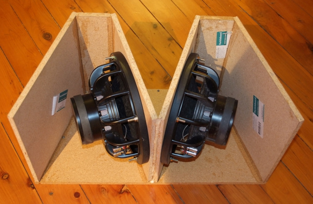

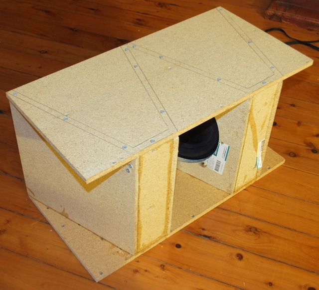

I finally got around to constructing a prototype of the "V-frame" dipole. As usual, no expense was spared...  :D
This is the inside view:
I'll try to take some measurements in the next few days...

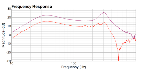

So here's a measurement of the V-frame dipole. Outdoors at 1m, 0, 30, 60 90. This is not a laboratory-grade measurement, just enough to see basically what it's doing ;)
This is at the front and rear openings:

I'm impressed!  Not bad at all IMO.

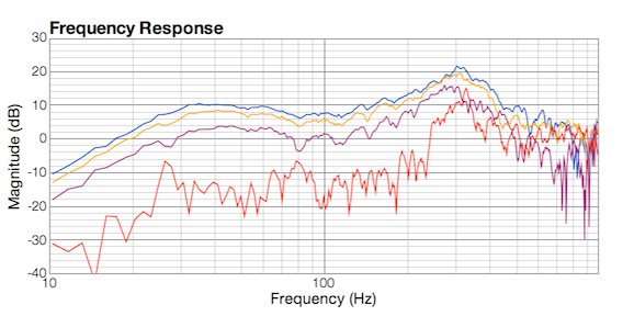

I'm going to try a bit of stuffing in it, I'm curious to see if it flattens the peak out some.

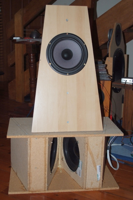

Had a pair of drivers and a test baffle lying about, so thought I might as well try something:

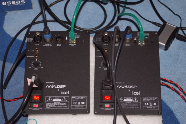

Amplification/crossover:
Obviously all very temporary!

I've messed with some stuffing to attenuate the resonant peak, it can be done but also reduces output elsewhere as well. So I'm figuring these (the small V baffle) are good up to about 200-250 Hz.

John , I am not familiar with the plate amp/DSP unit pictured. Is that available consumer/USA ?
Hi, it's fairly new: http://www.minidsp.com/products/plate-amplifiers/pwr-ice125
Not sure exactly what you mean, but it ships from Hong Kong.
