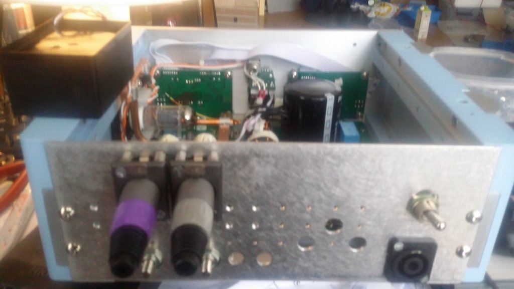

Just a small update.i dud start with the metalwork for my new sensation. The last one seems to have come from a different production run or someone who did do the metal work needs new  glasses or a better machine. Some things didnt fit 100% And i had to do some afjustments. I just did copy the spare part i did do myself and added a few holes.
There will only be one set of xlr input, there will bea lundahl transformer who will change the balanced output from my pre amp to an unbalanced one. There will be at 600hertz filter with 12 db slope.
The speaker connectors will be on top.
I did put a decent power switch and high amp rating connector.
Have to find a solution to mount the tube buffer black box. It was glued but did come loose during transport.
The stand offs i did use for the print are just 2 mm higher than the original and now the buffer dont fit. Anyway it was mounted in such a way that i did decide to change it anyway. You need to do a lot of cursing to get it out especiallywith all the wires and the bigger caps.
Ooh yeah the caps the caos will be changed too.

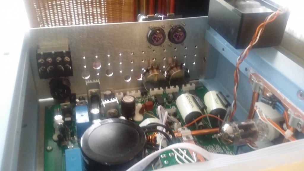

As you can see i did create some xtra depth by turning the aluminum piece that holds the back panel 180 degrees and also did create some extra height by omitting the sliding top panel. The top panel is nearly invisible in my set up so i dont mind.
Need the extra height too to mount the black box from the notorious gary in a decent way.
If it sounds allright next week i will be happy.
I needed the space too for a better connector and power switch. I would rather have good connectors on the print and pay more and have columns and a fancy colour.

Today after work i will install a Russian oil cap 100nf and a 100nf Russian teflon or a French polystyrene( the one i am using in my other sensation). So i can switch between the 2 after a few weeks the 600 hertz will be used too. So it will be used between 100 and 600 hertz. IMportant frequency part so cannot use crap cap like soniccap lol.
Sincere greetings, edward
bardamu
Re: Can I use a preamp with the sensation m901?
« Reply #19 on: 22 Jul 2014, 05:59 pm »
Hello,
Installing the caps i will need daylight. The person who did install the sonicaps must have bad light because the soldering doesnt look to well. Might even be a cold joint. So i will do it friday afternoon and take a half day off at work and use my special electronic light which is at the kitchen table now. But that one cannot be used for electronics all the time.

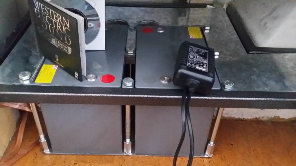

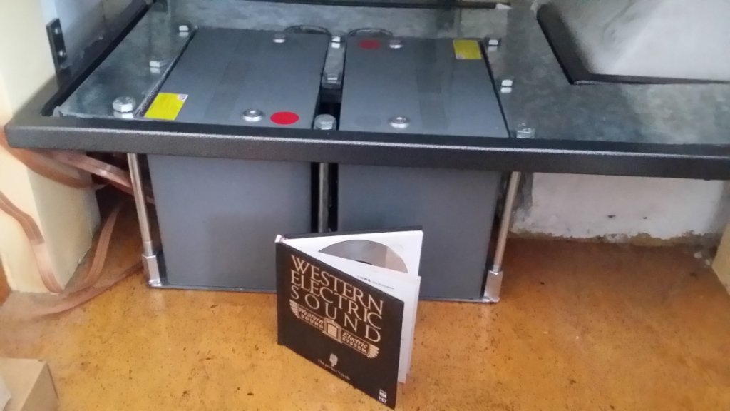

I did get the batteries, they are heavy and big. If you see them you know it would be nice to change the connector and the power switch too.
This was the biggest battery that i could install into my rack with just some minor changes. Batteries usually have a position that will make them work better and last longer than in other postions. Especially charging is best done with the connectors facing upwards.
There will be another panel mounted on top of thepanel with the big holes in suchs way that i cannot be moved and kind of locked by the 9 hexagonal.........
connections between battery terminal and power connector at the back of the sensation will be maximium
