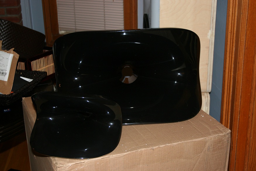

Just received my Iwata horns in the mail today.  Wow, they are smoking hot in person!   Its going to be hard to photograph them with justice.   I got the Iwata 300hz and the 600hz.   With the intention of keeping dispersion higher.    I will of course be trying out the Beyma TPL150Hs with them as well, but it is good to have choices.

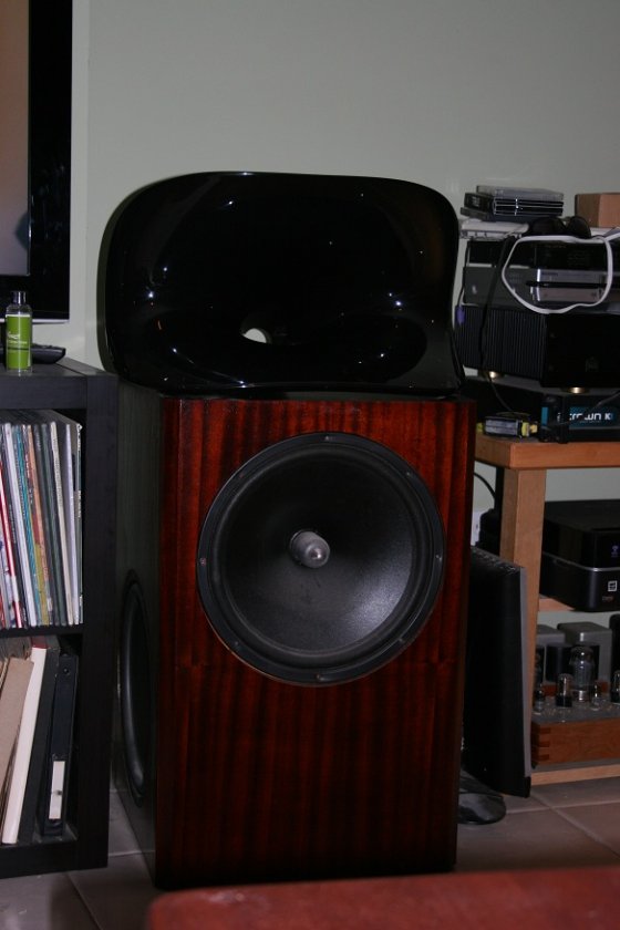

Josh, are you going to post some photos?  I'm keen to see these.

Just a couple of raw photos.   Haven't really set anything up yet.   Been procrastinating...

Please post pics of the amps and the setup when you get a chance.  The speakers look great.
