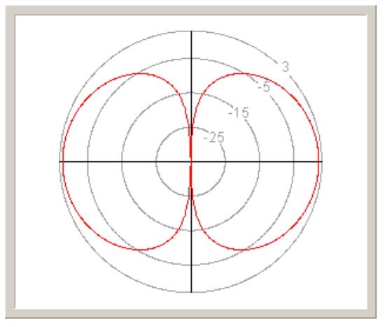

OB have a null to their sides, so closer side wall distance is a little less critical than rear wall.
studiotech
Re: Vertical or horizontal for Neo10 OB
« Reply #32 on: 15 Apr 2013, 05:50 am »
To a certain extent yes this is true, but too many folks forget that the major drop in SPL is directly to the side, 90deg from the front face of the drivers.    The side wall first reflection point is still illuminated about as much as with a standard boxed speaker, so if they are very close or set up with non-symmetry, this can still be a big problem as in my own case.  Now, IF the baffles are toed way in, aimed directly at the listener, this can push the null into a beneficial spot further down the side wall.
Greg
