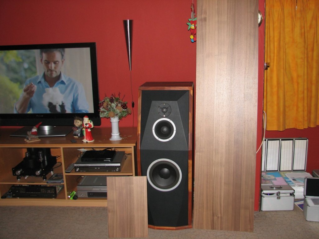

That one worked! There is a spare [/img] tag at the end though.
Nice wood!

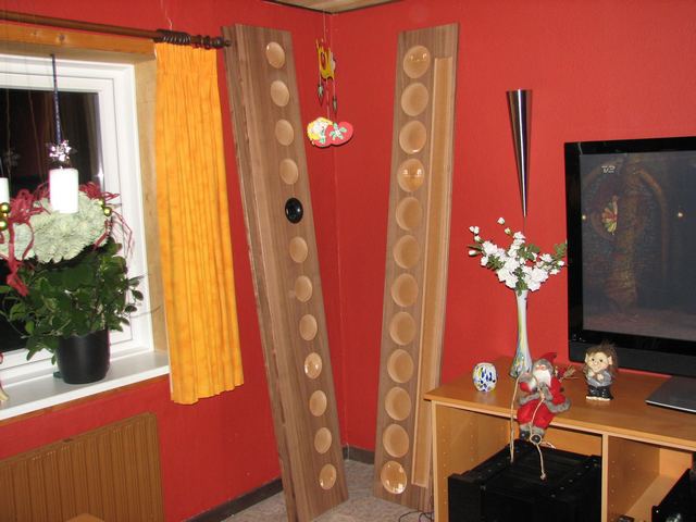

« Reply #24 on: 21 Dec 2012, 08:39 pm »
A bit closer to finish

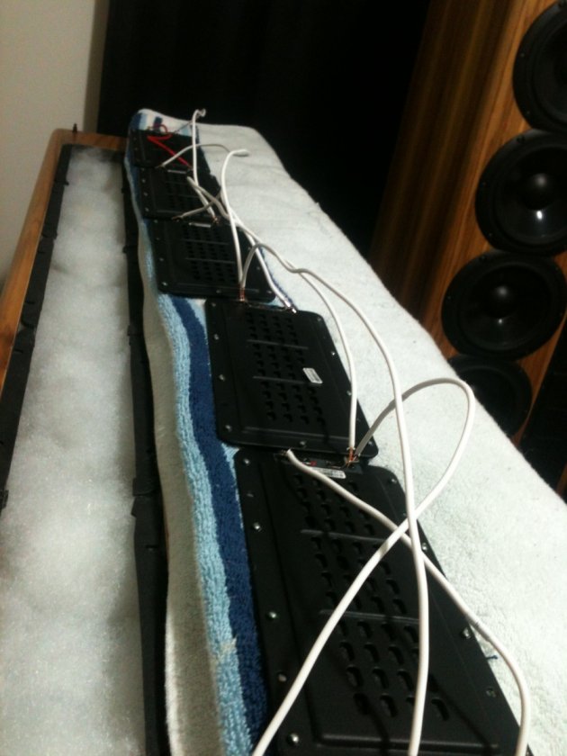

Hello
What is best to use,for the drivers,,spades or solder ?
i am a bit worried af soldering the Neo8
Danny Richie
Re: Build LS-9
« Reply #33 on: 25 Dec 2012, 05:08 pm »
Hello
You don't want the signal to have to pass through a bunch of slip on connectors. That will just degrade the signal. Solder the wiring directly to the drivers.

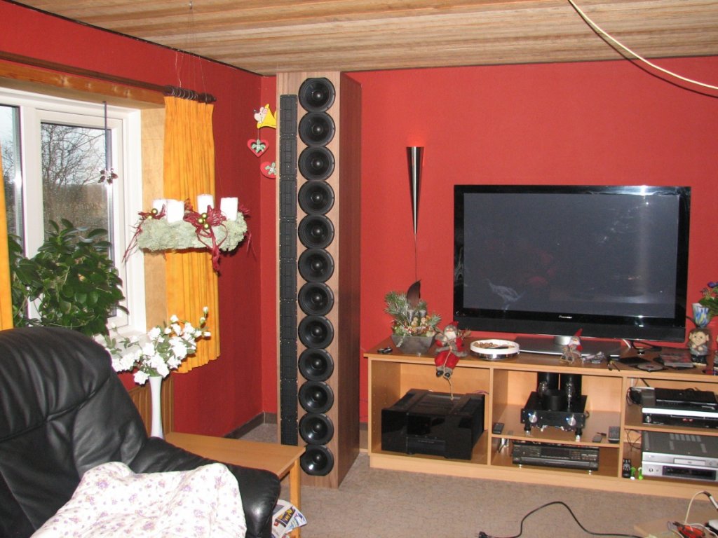

« Reply #37 on: 27 Dec 2012, 08:11 pm »
A little opdate
tomorrow it is time to mount the braces,,,the bitumen and foam
the plan is to get the speaker to play, at new year evening...could be a great party :D
tubesaab
  • Posts: 108
Re: Build LS-9
« Reply #38 on: 30 Dec 2012, 12:47 pm »
LS-9 op and running---will tell more later
