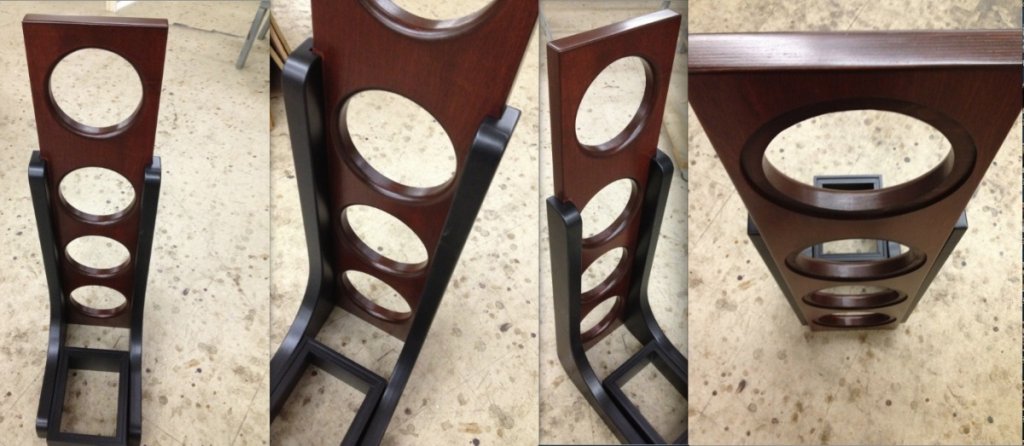

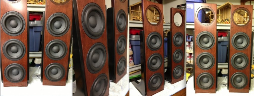

                With help from Danny , jparkhur and Dave, here is a full range driver speaker product.  The pictures are of the driver and baffles from jparkhur for the Dayton PS220-8 driver as a test driver and three of the 8” GR-Research servo woofers.   There is a separate cabinet for each of the new servo amp to drive the 3 servo woofers.
                The reason behind the project is to see if using new impulse response correction techniques we can improve the sound of any full range driver.  The Dayton 8” full range driver is a test case, as it is a very good sounding driver.
   My part of the project is the supercomputer digital crossover.   The idea is that I measure each Dayton full range driver and do impulse response correction and crossover  for each driver.  This makes logisitics interesting as each driver has to be cataloged with the data.  They will be sold as pairs with the digital crossover for a specific speaker.
   The digital crossover will have two different stereo output stages.  One with be passively coupled from the DAC to the power amp to full range driver.   This will help protect the full range driver from extended low frequency excursion. The other will be a DC coupled output stage for extended bass response to drive the servo amps.
   The digital crossover and DAC’s will not use any linear phase filtering.  The input will be either via asynchronous USB directly from a PC music server or via a 24bit/192KHz A/D converter.  The processing rate will be 32bit/192KHz floating point math for all four channels.
   The digital crossover prototype will only have A/D conversion until the full production crossover is completed.   There will be software for a PC Music Server to run digital volume control and input switching between the A/D and USB inputs.
   Working on final pricing on the digital crossover system and driver pair.
   Will post in the thread progress as it is made along the way.
                Presenting The Monolith speaker.

Can you post more pictures of the cabinets? The picture is somewhat dark.

Here is a better picture of the Monolith baffles and one of the amp enclosures:

This may help..  Jon Parkhurst
jparkhur
Re: Best sounding full range driver speaker ever!
« Reply #6 on: 6 Nov 2012, 01:59 am »
And this...   More to come... from The Monoliths......
Yes= three 8's is similar to two 12's from Danny.. Order both...
Yes= this is fun and bottom end sounds great... waiting on the top to finalize... .....its like Xmas... early

HAL, interesting concept.  I notice that the servos are set up on a completely open baffle along with the full range driver; is the output on the full range driver low enough (or the servos together high enough) to not require the same H-frame baffle design Danny has been using in the V1/super-v/super-7, or are you simply increasing the gain on the amp to compensate?
Also, any thoughts on isolating the vibrations in the baffle from the servos on the full range driver, as I was under the impression that with the amount of movement the servos could deliver, transmitting vibrations could be an issue?
JP, very nice work, as usual!  I really like the look, and engineering the amplifier box to be a counterweight to the driver loaded baffle looks to be a most elegant looking solution.
Danny, is the output of the servos in this configuration enough to work with the top half of the V2, or would the servos need a shallow H-frame as has been discussed in other threads?  I'm pretty sure if the answer was "yes", at the very least Tyson would be looking at his piggy bank with a hammer in hand.  :green:
