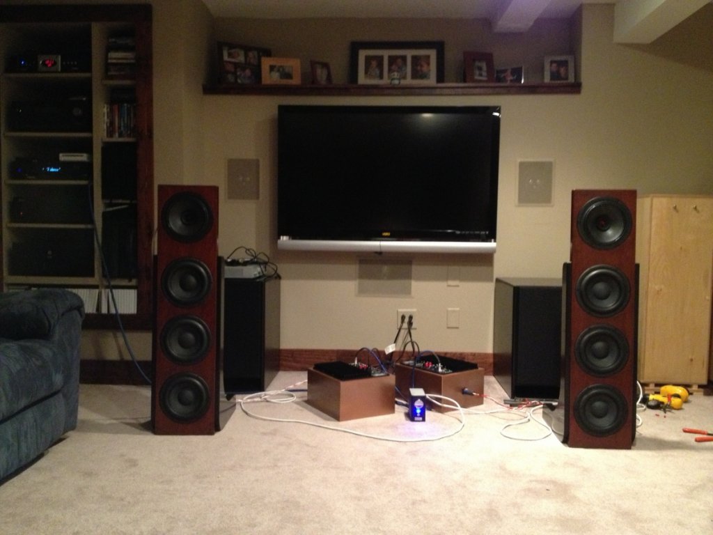

jparkhur
Re: Best sounding full range driver speaker ever!
« Reply #118 on: 28 Nov 2012, 02:13 am »
HAL
  • Industry Contributor
  • Posts: 5588
« Reply #119 on: 28 Nov 2012, 02:26 am »
Jon,
Looking good!
I started installing drivers this evening.   Should be done by this weekend.
