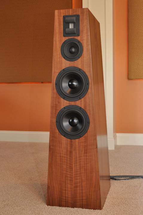

Here's the MA-1 which uses Wavecor drivers with a RAAL tweeter (I believe we were the first U.S. manufacturer to design with Wavecor).
