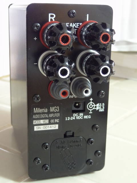

I've modified my Millenia as well.  I've changed the RCAs and binding posts and replaced the fuse with the AMR 3.15A fuse.  I'm awaiting parts to do the power supply mod.
The binding posts I used were WBT 0703s http://www.wbt.de/fileadmin/ppr-ftp/WBT-0703_Cu_Datasheet.pdf
The RCAs were WBT 0210 Cu. http://wbt.de/index.php?id=73&backPID=73&tt_products=56

Those look nice. I will probably have to try those. Did you have to do any filing or alterating the chassis?

I had to make some changes to the case.  I had to enlarge the holes for the RCAs and the binding posts.
The WBT 0703s were larger than I thought they would be.  I now think that the WBT 0708s (http://www.wbt.de/fileadmin/ppr-ftp/WBT-0708_Cu_Datasheet.pdf) would be better as they are a bit smaller.  I'm going to use these for my next mod.
I'll post some pictures in a couple days.

« Reply #15 on: 26 Oct 2012, 01:10 am »
Hi,
As promised here's a picture of my modified Millenia:
Regards,

« Reply #16 on: 26 Oct 2012, 01:18 am »
Looks a whole lot like a Virtue. It will be neat to pick up on Monday.
