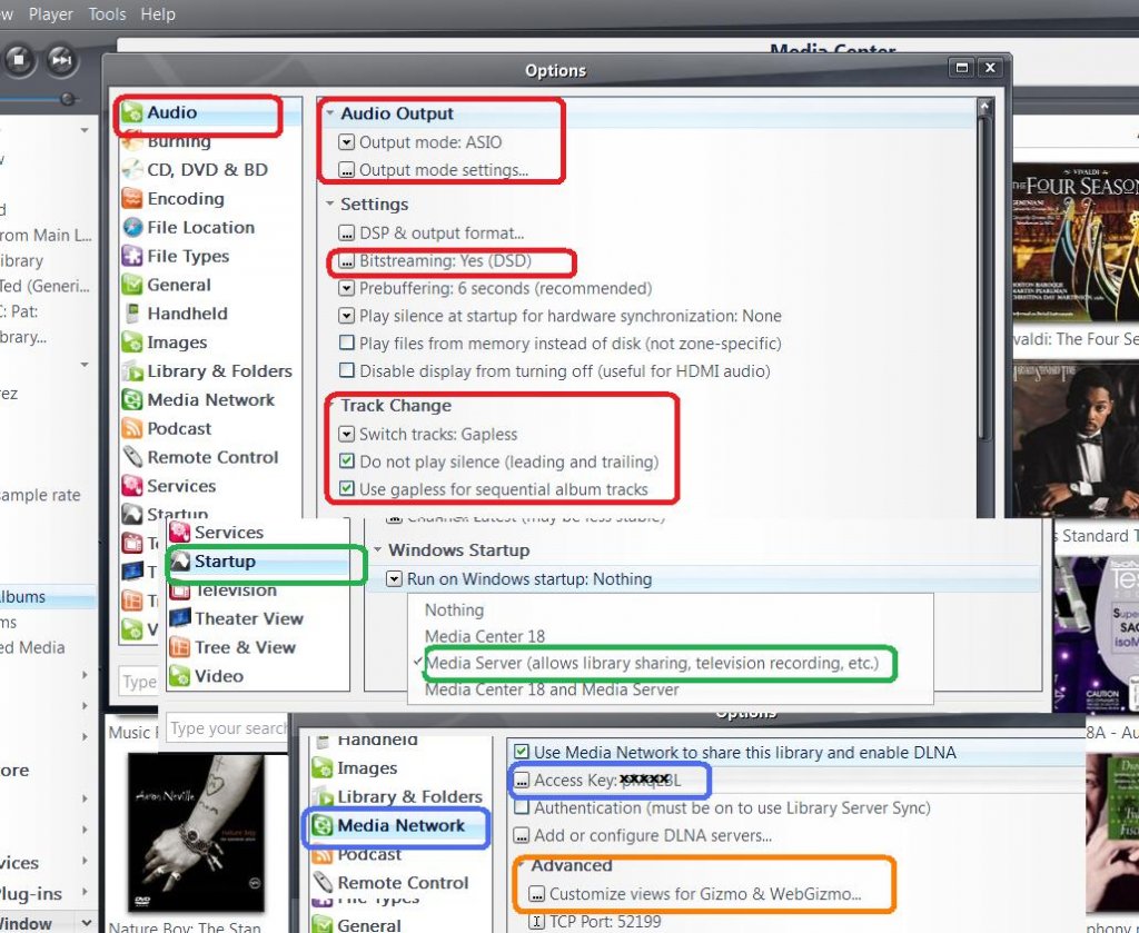

So here is a quick rough "get you started" J River MC18 screen grab compilation.  All this work is done via Tools->options
(These screen grabs came from my desktop MC18, not CAPS so I am using ASIO on desktop, WASAPI-EVENT Style on CAPS.)
Red setup is Audio.
 There are sub menus for the two radio buttons under output.  Setup includes DSD bitstreaming (if applicable).  If doing up or down converting then go to DSP output and formats screen.  it's pretty intuitive.  NOTE:  DSD downconverting requires you to pick the category "over 192k" and then you pick your sample rate you want DSD down converted to.
Green setup shows where to select Media Center on startup.  This is for jremote users; this way the GUI screen doesn't come up (but is available if needed)
Blue setup is where you click and it gives you a random unique access key.  This key will be asked for in jremote's initial setup (similar to when you ask Apple remote to synch to iTunes the first time).
Orange setup is the place where, later, for advanced users, you take your customized views and add them to jremote (nice feature, easier than it looks).  I have a small tutorial earlier in this thread, or here:

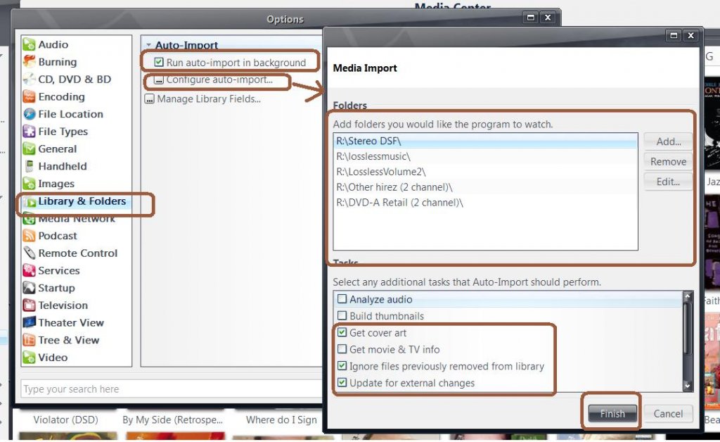

Finally, now that JRMC18 is set up, it's time to add music.
Brown setup is to allow MC18 to see and constantly monitor (auto-import) your music files.  You can point to internal drives, local external drives, or NAS (mine).  So my process is to rip or download new music on my desktop machine, clean up, add to my NAS (which is available to my home network) and have MC18 monitor it.  It usually takes about a minute or two for newly added music to show up in my MC18's.  Then I'll clean the tags if needed.
