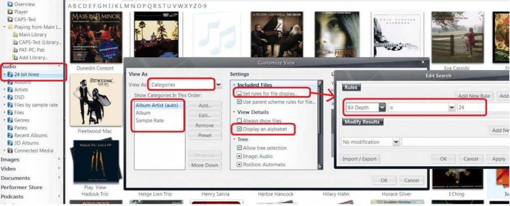

Here is a small Ted primer :)   I've circled, in red, anything appropriate
First click on Audio tree, then go to view_>add view->add library view, and pick empty one
give it a name (mine is "24 bit hirez")
change "view as" to categories (so you can see album art)..it's a pull-down pick
add sorted fields.  the sort order is the view order (i.e mine shows artists, then you pick albums, then if albums are available in multiple sample rates, you pick them).  Experiment.
add any rules under "set rules for file display" (my only rule was bit depth.  My DSD view differs simply in that my only rule was "file type is DSF", and I had no sample rate field).
add "show alphabet" if you have large lists to browse
Done!
(Note:  sorry, not sure why my image is so small.  It isn't a small jpg at all.  So I chopped it down to the important area of the screen))

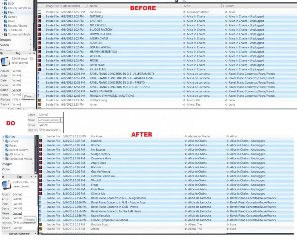

Other good things to know in J River, especially for advanced bulk tagging techniques:
* the expression language.  things like =fixcase([field-name]) will remove all caps that often come from DSD rips, etc.  So highlighting an album whose song names are all caps, and putting =fixcase([name]) in the tag area for name takes on the default capitalization rule (Capitalize first letter of important words).
