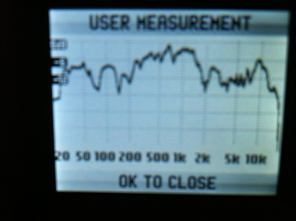

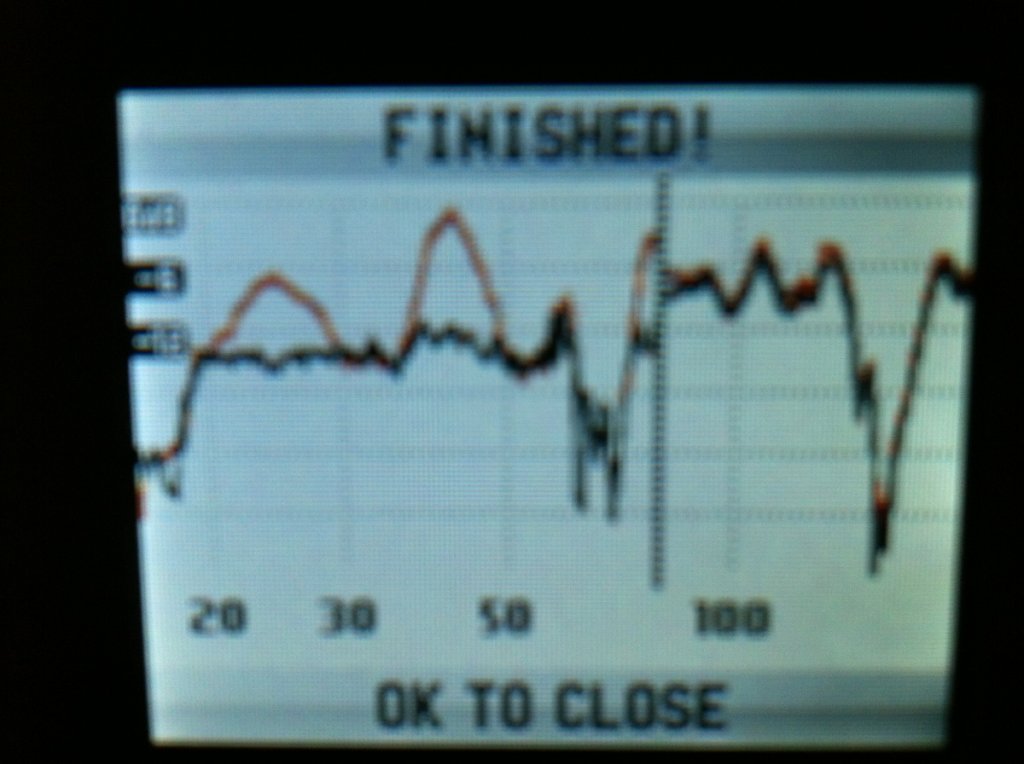

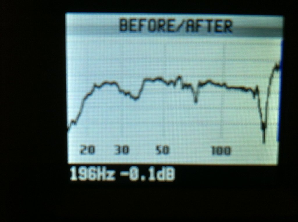

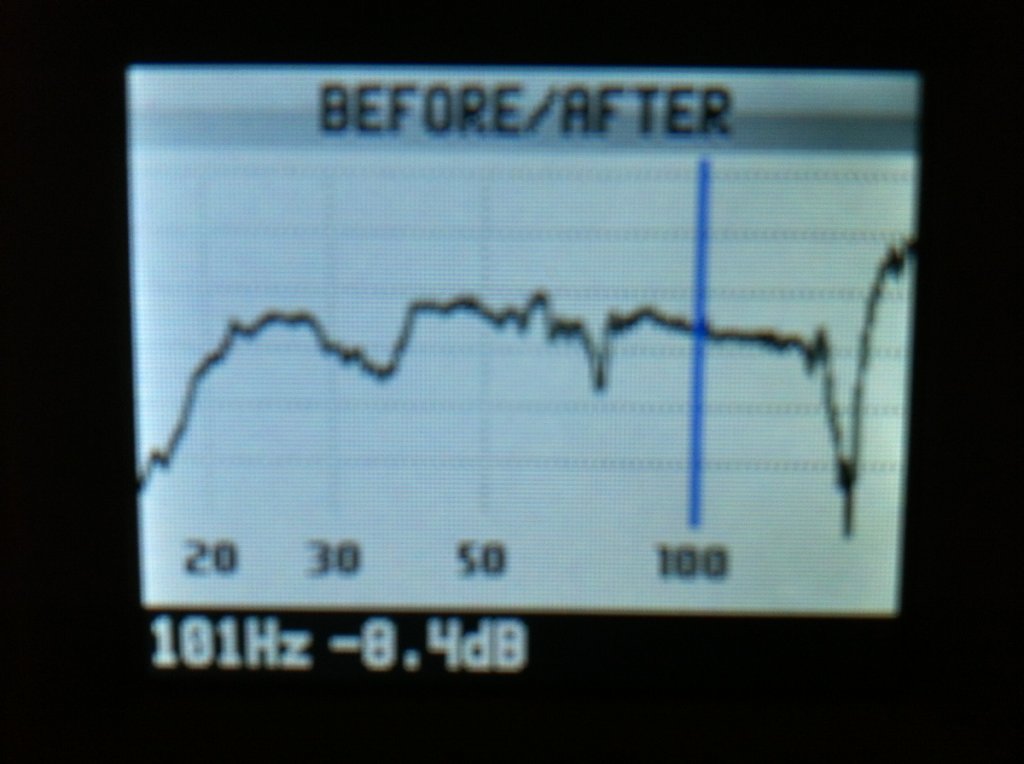

Hello again.  I have not had a chance to try any of the suggestions, but I do have some pictures of the DC screen.  Sorry for the blurry pictures.
First is the before and after(w/sub).  The suck out on the right side of the picture is the dipolar cancellation that corresponds with the Maggies distance to the front wall.
The dip in the 28Hz-42Hz range is just sub-woofer crossover/level matching.  I am NOT addressing that in this discussion.
In the following pictures I have set the cursor to positions that illustrate levels I am addressing.  You will note ~8dB drop in the corrected bass range, below 200Hz.
Next is the after cal curve with the cursor at 101Hz, note -8.4dB level.
Now the same curve, cursor at 196Hz, note -0.1dB, cursor is at the extreme right edge of screen

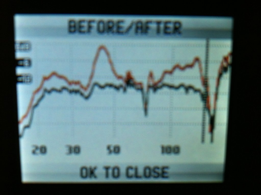

Guidof, Your suggestion about increasing the frequency of correction above 200Hz helped.  I ran a calibration up to 500Hz and the transition is less sever.
In this picture, the response curve shows a bit flatter line on either side of the null at ~170Hz.
Here is a full 20-20k curve.  Boy is that ugly!
I don't consider this situation to be solved, but a long with House Curve & Bass level it is a step in the right direction.  Regarding loading the DC screens into a PC, I no longer have a laptop (iPad), so I will have to unhook the DC from my listening room and tote it up two flights to my desktop.  I will try that soon.

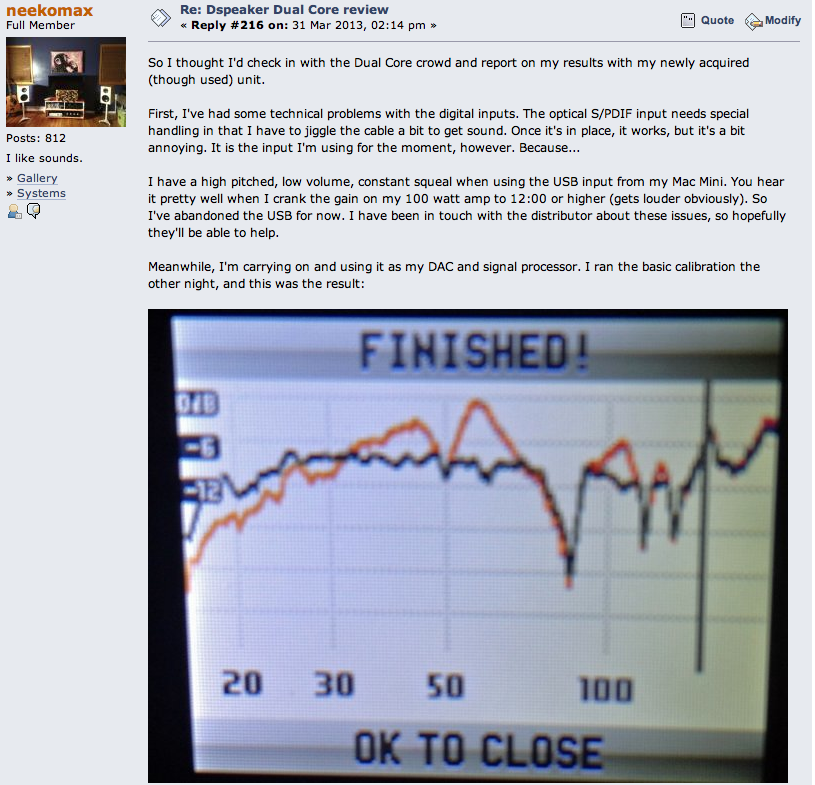

I guess no one noticed my (re) post of my original before/after graph. The reason I did so is that it looks a lot like sparky's in the way that the bass seems to have been pushed down at least 6 dbs overall in relation to the mids, which you can start to see on the right of the graph. My solution, since my speakers have active bass, is that that I did another calibration with gain on the subs down from about 12:00 (where I normally have them) to about 10:00. Then, after calibration, I have turned them back up to about 1:30. This has pretty much fixed the lack of bass post-correction, although I'm still not quite happy with the sound yet.
Perhaps the reason the DC does this is that, since it doesn't want to/can't boost the nulls, it cuts the peaks down to where the average response is down from the rest of the spectrum, but flat (isn).
Another question: When using advanced calibration, the 'compensation' setting sets the amount that the DC boosts the bass overall post correction (I suppose as a measure to address the aforementioned effect), correct?
Sparky, other bros,
This is my post from when I first brought mine home a week and a half ago, and ran the basic calibration. Look familiar?
