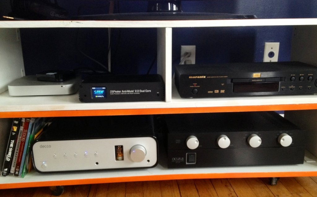

I just plugged the DSPeaker analog out into the Aux 1 input of my Peachtree Decco (instead of going straight into my Acurus amp as I had configured previously, so now the DC is DAC/DSP, the Decco is preamp.
Best sound yet! The tube buffer in the Decco adds that touch of smooth warmth, and together with the detail and resolution of the DC as DAC, the corrected bass, and the ss power of the Acurus... Aw yeah. THIS is what I was hoping for when I threw down for the DC. This is great.  :icon_lol:
F*#@ yeah!
