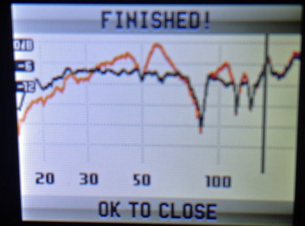

So I thought I'd check in with the Dual Core crowd and report on my results with my newly acquired (though used) unit.
First, I've had some technical problems with the digital inputs. The optical S/PDIF input needs special handling in that I have to jiggle the cable a bit to get sound. Once it's in place, it works, but it's a bit annoying. It is the input I'm using for the moment, however. Because...
I have a high pitched, low volume, constant squeal when using the USB input from my Mac Mini. You hear it pretty well when I crank the gain on my 100 watt amp to 12:00 or higher (gets louder obviously). So I've abandoned the USB for now. I have been in touch with the distributor about these issues, so hopefully they'll be able to help.
Meanwhile, I'm carrying on and using it as my DAC and signal processor. I ran the basic calibration the other night, and this was the result:
As the user manual warns, once corrected, one may perceive a lack of bass. Did I ever! I guess I've become very accustomed to my speakers with their dual active subs overloading my room with bass. So I've set the house curve pretty high on most music, and I turned up the gain on the subs in my SAM 1s from about 12:00 to 1:30 or so to compensate. I may turn them a bit more, we'll see. I'll run a room response analysis first to get a handle on just how much boost I'm actually applying. From what I gather, these compensations should fairly equally boost the bass, instead of just having certain arbitrary frequencies super hot as a result of room modes, which is what I was hearing before the DC was in my system.

I also have a finicky optical input. Now that you have those measurements and the mic, you can also play around with speaker placement etc to get rid of that big dip.
Huh, interesting to know I'm not the only one with this type of issue.
Good thought on trying to get rid of the dip around 80 Hz, but I don't have much flexibility with speaker placement in my small room. What exactly would you try? I think maybe adding a third sub might be the most effective at fixing that, no?

A third sub might work, if speaker and/or sub repositioning isnt' much of an option. Not sure how much working with room treatments or rearranging other parts of the room may also help with a dip like that. The Dual Core can try to bump up that dip a little bit, but read the manual on that. They discourage against too much, for very sound reasons IIRC.
