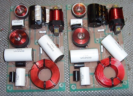

I purchased the upgrade kit directly from Danny. Which replacements would you recommend? Here is a picture of an upgraded LS-9 crossover and it still has Erse caps.

Picture of upgraded x-over

Enjoying the build as well. I have a pair and I'm up to the no rez and port tubes installed. Be interested in pictures of the wired drivers, tweeter, bass managment and x-over if you think of it.
I didn't take any pictures while I was wiring that stuff up. I had to drill two small holes at the back of the tweeter section near the bottom. I drilled so that the wires would just fit through and aligned the holes with the tabs on the back of the bottom tweeter. I turned over the tweeters and wired them per the wiring diagram from Danny. I then had some more help and flipped all the tweeters over together and put them in the tweeter section.
The drivers were all laid out and I ran all the wiring and tinned the ends. Don't tin the ends over the speaker cabinet. On my first one a drop of solder landed on the cabinet. :duh: I then started at the bottom and soldered the wires to the drivers. Once each driver was completed I turned it over and set it in the opening. This way I could use shorter wires. I ran the wires through the brace hole that is below the tweeter cabinet.
The bass management connections were confusing me and I ended up talking to Danny about it. Below is a picture of the bass management and crossover. The bass module was designed to have the binding posts connected to it through the big holes at the bottom. It module was then wired to the crossover's inputs. However, if you use the tube connectors you can just wire directly from the tube connectors to the crossover.
I installed the tube connectors on the access panel, attached the wire lead and connected per the stickied thread at the top of this subforum. I then ran the wire lead through the bass module's hole and screwed the bass module to the access panel. Next I connected the tube connector leads to the crossover and then the bass module to the crossover. I drew connections for the wires in the picture. The last thing I soldered was the woofer and tweeter leads to the crossover board. Note that the red and white wires are reversed for the tweeter and woofer. I couldn't read the + and - very well on the woofer connection and wired it first with the red on the left just like the tweeter connection. I later looked at the other crossover before I connected it and realized my mistake.
Finally I put the crossover in the speaker and screwed it down with Spax #8 1" screws. I had to use a short (but not a stubby) screwdriver. Make sure the crossover is back far enough to leave room for the bass module when you put the access door on.
