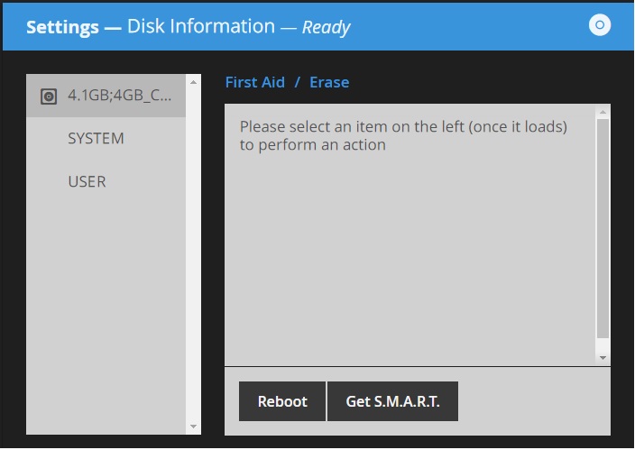

Concerning the scratch drive, I read the bit in the manual, does it have to be a USB drive since it says any locally attached drive? I don't have any USB's attached and there is only one option in my list? See below.

« Reply #2027 on: 28 Nov 2018, 02:32 pm »
That's the internal storage that's listed and is whats currently being used, its not really critical until you run out of space completely and even then the unit will still continue to function, but the interface might behave a bit odd.  You only need a 4-8GB usb thumb drive to plug into the rear of the unit.
