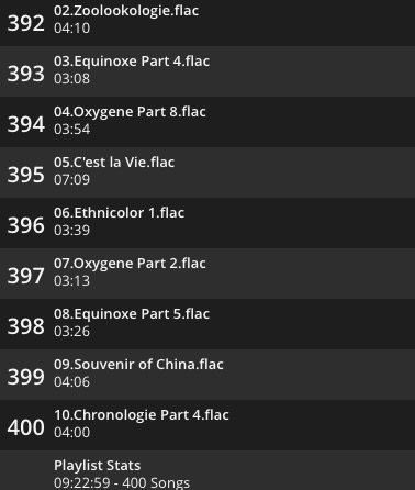

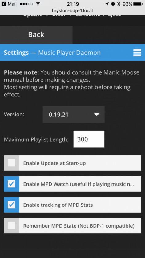

I too would like a longer playlist. I tried it on my BDP-1 earlier and  tried to play around with different firmware versions and could not get it to change from 300.
I usually put an album at a time in the playlist at a time. 95% of the time not more than 50 songs. However, I do have a few compilation playlists of 600 and 800+. If I try to load it in the BDP-1, it only loads the first 300 in a row. I have no option to further add. Secondly, if I wanted to add tracks #301-600 on the playlist, it'd have to be done manually by clicking each track. It'd be good to be able to just hit the shuffle button and then just click on a playlist and let it play...However, I suppose MPD isn't built that way?

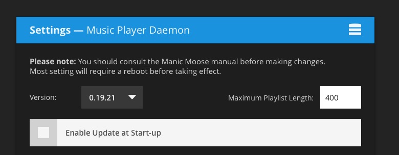

The other option would be to split those playlists into folder chunks of 300.
Just to be sure: did you try and change these settings?
zoom25
  • Posts: 1000
Re: BDP-2 Digital Player
« Reply #1887 on: 29 Jun 2017, 07:29 pm »
Exactly that. I tried all the version numbers (0.19.21 and others) and the Maximum Playlist Length.
Hi Zoom
Just checking, after you changed the playlist # did you then scroll down and press save? I forgot the first tome.
David
zoom25
  • Posts: 1000
« Reply #1892 on: 29 Jun 2017, 10:57 pm »
Hi Zoom
David
Yup. I've tried it like 15-20 times. Even restarted the BDP a couple of times whenever it requested it. I'll give it a try again and update it again if there is something newer and see if that makes any difference.
To get mine to stick to 600 I made those changes hit save and then immediately restarted the BDP-1.  That got the setting to stick.

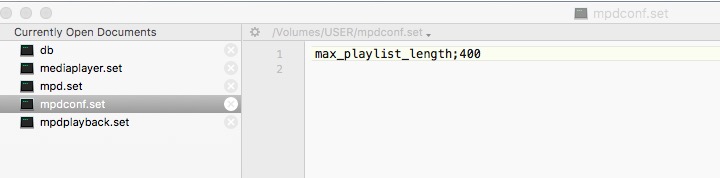

One could always try and edit the settings file (mpdconf.set) in the user folder manually . Maybe somehow the MM interface won't save it correctly (which would be a bug) but editing directly would work? Seems to stick here (changed the setting in MM, not in the file manually)
Cheers Marius
