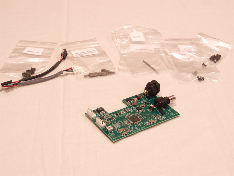

Hi James,
I'm a little confused...  :?
The upgraded IAD audio card only includes the SPDIF and AES/EBU output ports (as per the pic below).  How does the IAD improve/affect USB output sound?
James Tanner
  • Posts: 21004
  • The Demo is Everything!
    • http://www.bryston.com
Re: BDP-2 Digital Player
« Reply #1276 on: 2 Dec 2015, 06:31 pm »
I think he had not really tried the USB before and was surprised at the quality he was getting.
james

plurn
  • Posts: 11
« Reply #1278 on: 3 Dec 2015, 05:01 am »
Hi James,
The BDP-2's new Integrated Audio Device is a USB device - though that might not be clear to all since it does not use the usual USB connector we are familiar with. It connects to the BDP-2 motherboard via a USB header on the motherboard.
So when the review says "At last, here was "proof of principle" evidence that the USB interface could function as an audio conduit of the highest caliber.", the USB device he would be talking about would be the new Integrated Audio Device in the BDP-2.
