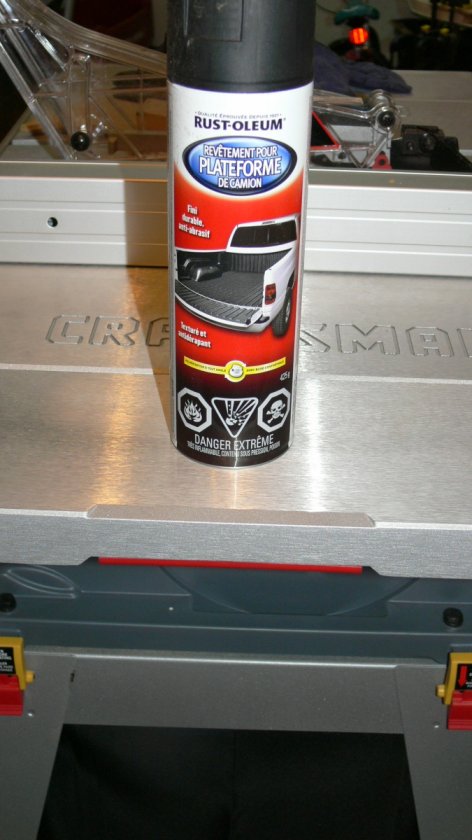

Just tried the truck bed liner paint. I found it went on pretty thick and the texture was far too heavy. I'm looking for something with a softer 'sandy' type finish: more like a powder coat look.
Any suggestions?

Is this the same  stuff you trired ?
Sometimes  Canada/US have different products.
I didn't find it too thick and like I mentioned in my thread,  I'd say it gave me the finish  of a piece of 240 grit sandpaper.  When you run your hand over it ,  it feels, well  "sandy"  I  guess :)
Hope you find something you like  !
-jay

I used the brush on version of that product. I have to say it was more like popcorn ceiling texture. Perhaps I'll try the spray on version.

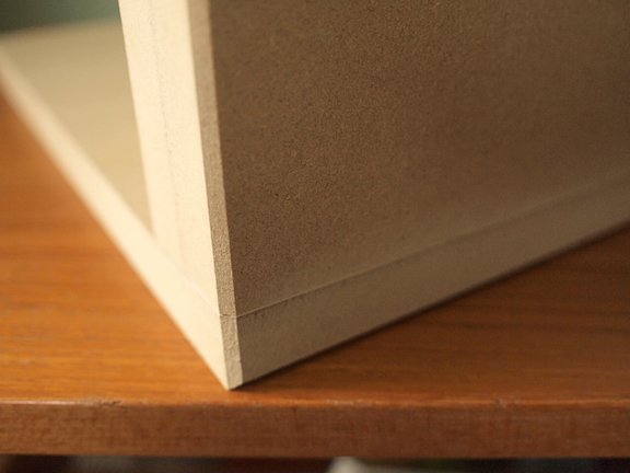

A few shots of the upper baffle:
A good shot of the seams and the 45° edge I gave the front:

Hehe,  yeah the spray on stuff wasn't  very thick.  If you try it. be sure to  shake it  often while spraying (every 10 seconds or so).
I was going to try the brush on/roll on stuff but HD was out of it.  I ended up trying the dupli colr roll on stuff from Canadian Tire and  I found the same thing... it was way too thick and lumpy.  On top of that, the dupli color stuff was "rubbery".  The spray on stuff from HD dries very hard.
So far, the people who have seen my  N3's in person really like the finish
-jay

I like the 45  on the front edge, looks good

the rattle can version of the bed liner paint is much better than the roll on version. Same product label but much different -- I think the spray on is what I'll go with.
The plan right now is to use a spray can primer on the bare MDF, 2 coats. Then a light sand. Then 2-3 coats of the bed liner paint.

That's pretty much what Idid, but I rolled the primer, 2 coats then sanded with 400 before using the  spray on bed liner.

There seems to be one trouble spot with my construction.
With so many butt joints coming together in one location, 1mm off is a mile. This area is important in the design and needs to read as one smooth surface.
I've been building up wood filler and fine grain drywall filler to smooth out these areas. I've found that a full sheet of sandpaper on a large flat block works excellently for smoothing out the fill on a large area. Also, I have to remember to be patient and let the filler dry throughly before sanding (12-24 hours) for best results. It is a little slow but the results are fantastic.
With luck the skeletons will be painted by Monday.

You may not be able to hide that seam unless you lay a piece of veneer over it.
