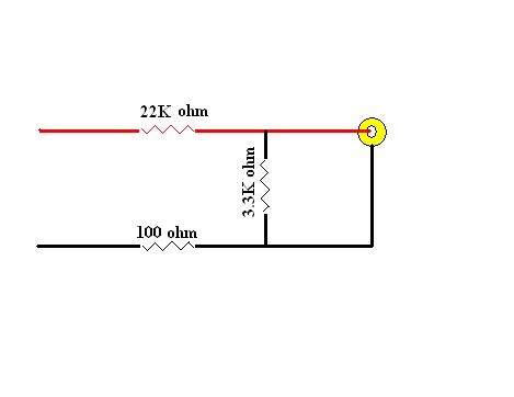

Hi,
Does anyone have the wiring schematic on how what value resistors should be soldered in line?
This was the old link but it not longer works:
http://audioc.com/house/speakers/force.htm#More
Thanks!
Joe_K
Re: Need speaker level converters for Titan II LE
« Reply #5 on: 25 Feb 2017, 06:04 pm »
I don't remember the function of the 100 ohm resistor, otherwise it's about a 7:1 divider.
Joe

Thanks!
I image 1/4 watt resistors work
Joe_K
« Reply #8 on: 26 Feb 2017, 08:10 pm »
1/4 watt is fine.
I would use metal films or other quality resistors.
