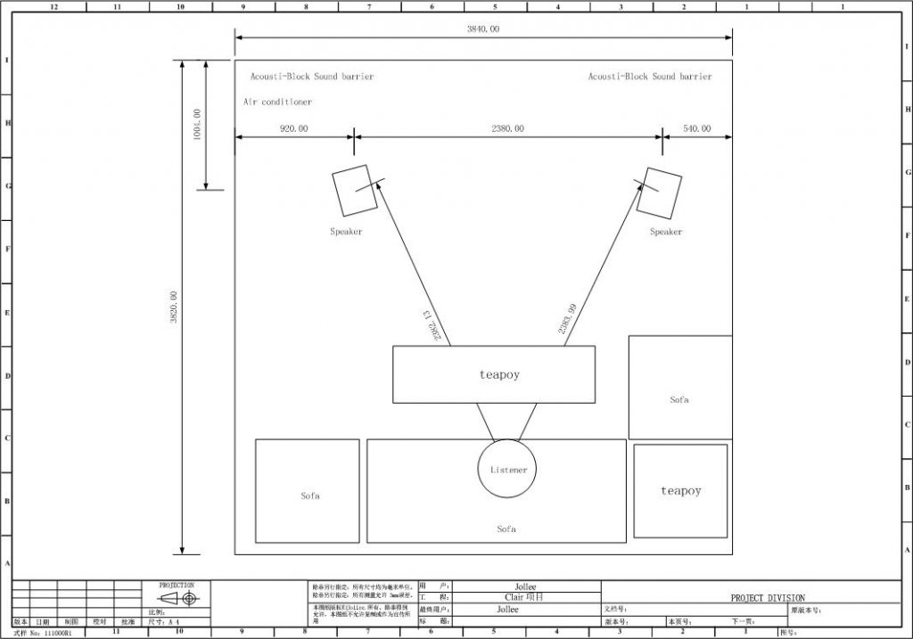

Hi everyone,
I am quite interesting for Danley SH 50, But due to my poor english, I hesitated to ask questions and get no feedback.
My Room size is somehow like this:
My questions are:
 a) is this position suitable for SH60/50 ? in such distance any uncomfortable?
 b) A room like this, how much watt the amplifer need to be? As I prefer tube amplifier, is a Single End 300B or A Push Pull PX25? or PP- KT88? can handle that?
 C) I just search a lot on Web, it looks like someone describle the SH50/60 as a big electrostatic speaker which can provide the same transparent sound as these system like stax, quad? but with even more energy?     As I have no Idea about that. Is it really sound like this?
thanks in advance.
Jollee
paulcasper
  • Posts: 3
Re: Danley SH-50
« Reply #51 on: 9 Oct 2012, 06:37 pm »
Hello Jollee,
Your drawing resolution is too low to read the dimensions, but I have made a few guesses and I will try and answer some of your questions.
1.  I see no problem with SH50 or SH60 speakers in the locations you have drawn.  Tom Danley would probably suggest you try the speakers up against the sidewalls to eliminate the sidewall reflections and improve imaging.  If you did that, you would probably have to equalize the bass down a bit because of the boundary reinforcement.
2.  I would suggest a solid state amp, but a higher powered tube amp with negative feedback (low output impedance) would be fine.  I used an Audio Research Classic 60 on my SH50s for a while, but an amplifier based on Hypex UCD400 modules was definitely better, especially in the bass.  I now use Hypex Ncore 400 modules.  I most definitely would not suggest a single ended amp.  In my experience, the frequency response of a high output impedance single ended amp as loaded by the speaker is very frequency and speaker impedance dependent, and you will not experience neutral performance.  You might like the sound, but it will not be accurate.
3.  I used Quad electrostatics for over 20 years.  I replaced them with Avantgarde Duos, which I used for 8 years.  The Danley SH50s replaced the Duos after living with both for a year.  In my opinion, the properly set up SH50s with quality class-D amplification, are in the same transparency class as good electrostatics, with vastly more dynamic capability.  Also, the SH50s are quite directional and thus do not suffer as much as dipole radiators from room effects.  This makes them especially well suited for 5.1 surround sound systems, where room influences are not desirable.  The SH50s, after much effort to set them up plus a bit of equalization to minimize boundary influences, are the best speakers I have ever heard at any price.  Of course, you must pair them with very good sub woofers to achieve full range performance, since they roll off below 50Hz.
I hope this is helpful, Jollee.  I will be glad to try and answer any further questions you might have.
Paul

hi jollee,
welcome to a/c!   :thumb:
if i am reading your drawing correctly, your room, at 3820mm x 3840mm is almost square.  and, not too large either, at ~12.5' x12.5'.  since these speakers are supposed to be wery directional, i suspect the danley's would do better in such a room than most, but i would suggest shifting everything into a diamond-shaped layout, w/one corner between the speakers, and the opposite corner directly behind you.  the other two corners will be to your left/right.  i would do this regardless of what speakers you finally end up with - it will be better to have more space behind the listening seat, and also have the walls angling away from the sides of the speakers.
arranging things asymmetrically left-to-right, as you have shown, will also be helpful, so standing waves won't be evenly reinforced.  but, you might want to shift the speakers to the left, so the right speaker won't be so close to the chair?  if you keep the layout square, i would also consider changing the distance from the walls; ie: instead of 1000mm for both speakers, try 950mm for the left speaker and 1050 for the right.  also, i would lose the table in front of the sofa.  even if you go w/the diamond layout, which i still recommend, i would try for a slightly asymmetrical layout.
regarding power, whatever amp you would choose, 5wpc would be more than enough, even in a room much larger than yours!  for a relatively reasonable priced, yet world-class low power tube amp, i would check out the almarro a205a mkll.  besides killer sound, it uses el84 tubes; the bigger tubes will act like space heaters in that room.  maybe ok in the winter?   :wink:
doug s.

Appreciated for all !
actually my current system just be placed in the living room, but with some decoration, I'll provide more photos for identification.
thanks!
