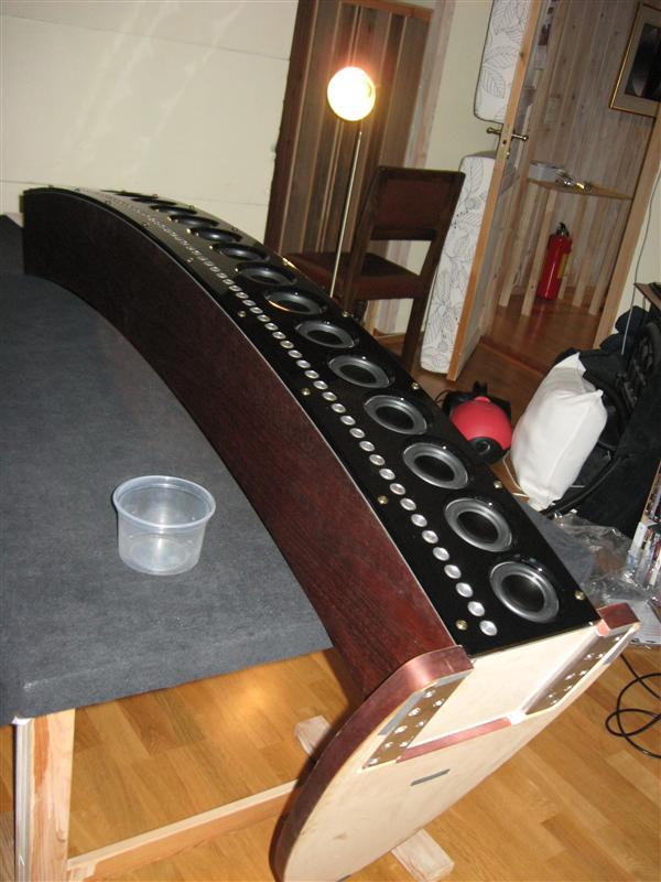

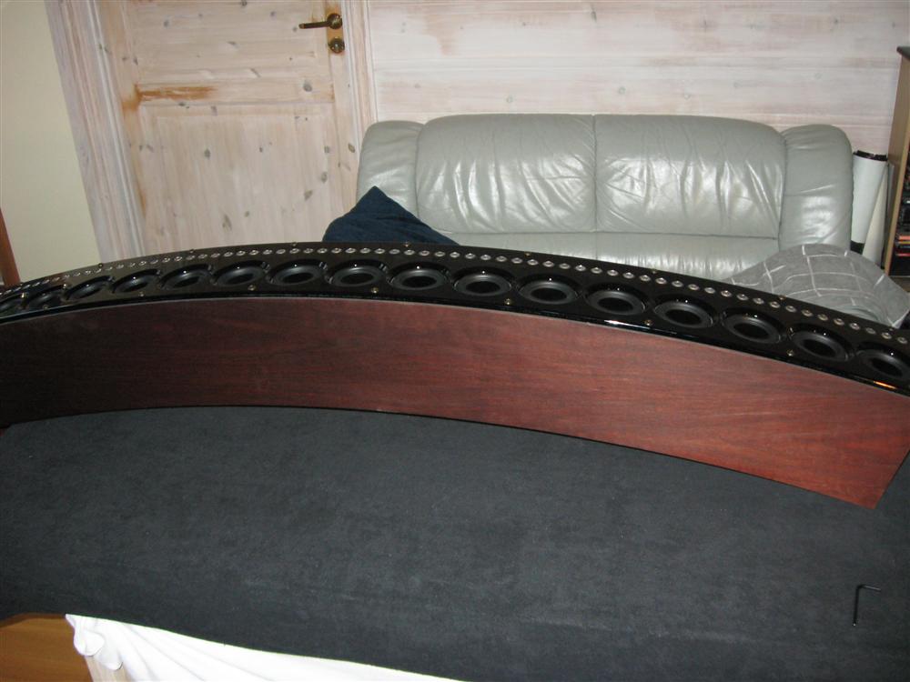

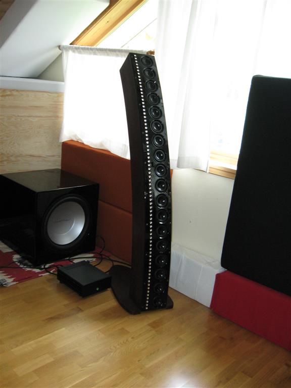

Below is a picture of a smaller CBT prototype. It measured great, but became omni earlier in frequency then CBT36.
Also a few pics of my CBT36 speakers. I certaintly wouldn't judge a speaker from a show by the way. I'm not sure now, but at the first shows Audioartistry demoed them with a ruler flat response. A flat response sounds too bright IMO and especially if the room isn't much treated. The beauty with an active speaker system like this is of course that you can tailor the response to the room and taste.

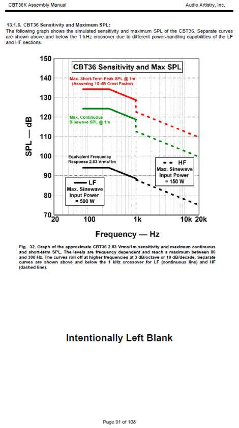

What is CBT36 sensitivity anechoic?
I suppose CBT36 rate of decrease vs. distance differs from normal mono pole.  For instance, monopole SPL decreases with square of increased distance, while dipole decreases at only one half mono pole rate.
The sensitive changes with frequency and falls the higher it goes up in freqeuncy. This is stated in the manual by the way:
Note: the raw sensitivity (no crossover or EQ) of the CBT36 is frequency dependent. It is roughly flat from 80 to 300
Hz and then rolls off at 3 dB/octave (10 dB/decade) up to 20 kHz. See later section “CBT36 Power Rolloff” in
Appendix 2 for further explanation of this rolloff. For more details see Fig. 26 in this section. Here are some
approximate sensitivity numbers at different frequencies:
80 to 300 Hz: 94 dB
800 Hz: 89 dB
8 kHz: 79 dB
The reduction of SPL is 3 db pr meter. It's 6 dB pr meter with a regular speaker. Because the CBT uses the floor as a mirror, the sensitivity of the array is doubled compared to a free standing array of the same height. Still, due to the fact that CBT36 uses ineffective tweeters, the sensitivity in the treble area isn't very high. But I don't believe it has any limitations for home usage. It can play loud. I've attached an illustration of the sensitivity and SPL of CBT36.
