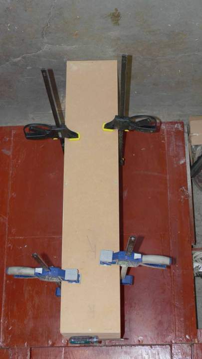

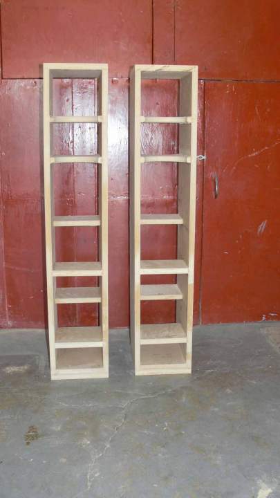

Anyhow,  I started on the cabinets last weekend.
I picked up a sheet of 3/4" MDF from Home Depot and was able to  get a fair amount of the cutting done there.  I had them  cut me 2 8" strips, 2 10" strips,  and a 6.5" strip.  From the  8" strips,  I had them cut me  the 4  front/rear pieces , from the 10"  strips  the 4 sides .
From leftovers of those  pieces, I was able to cut the 4 top/bottom plates.
I must say,  I asked the fellow to be extremely accurate with the cuts  and he  took his time and measured everything  twice before cutting.
When I got home, I cut up the 6.5 " strip into  the various  braces I'd be needing.

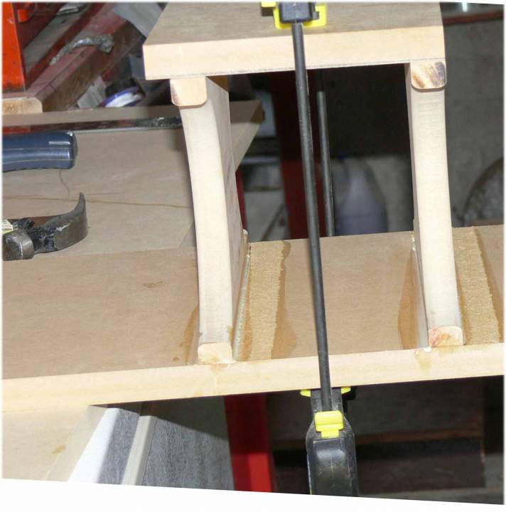

Now being that I only  started the weekend with  2 clamps,  I decided to mark out all the bracing positions on 1 side of the cabinet. I'd have to position and glue in  2 braces at a time (using a scrap piece of MDF and the 2 clamps for pressure).  It's very time consuming  doing it like this but  I had to work with what I had.  I had a difficult time keeping the braces square when clamping them down  but  with some  finicking around it is possible.

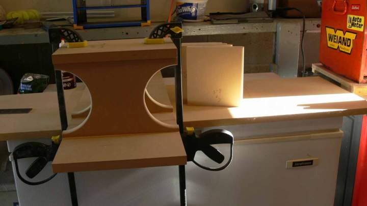

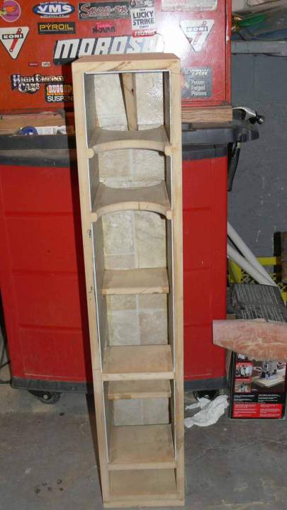

The 2 brace B's for each speaker I made from  a 6.5" x 21"  piece.   Once the holes were routed and radiused,  I cut the piece in half, then   cut the  excess from  each   end to make each of the resulting  brace B's  6.5 x10"  with a  semi circles cut in either end.
I continued  gluing in  2 braces at a time until  they were all  securely in  position.  Next I glued and screwed  the top and bottom  of the cabinet  in place..  Now that I'm writing this,  I realize  that I should have taken more photos slong the way.
I was able to get my hands on a couple more clamps which really helped.    Now I clamped the  second side in place and drilled the  pilot holes fro the screws.   The screws are all slightly countersunk to allow for a  roundover   later. I also slightly countersink the  holes that the screws will be  tighening into making sure that the boards  bind tightly.   Next I applied the glue,  clamps and screwws .

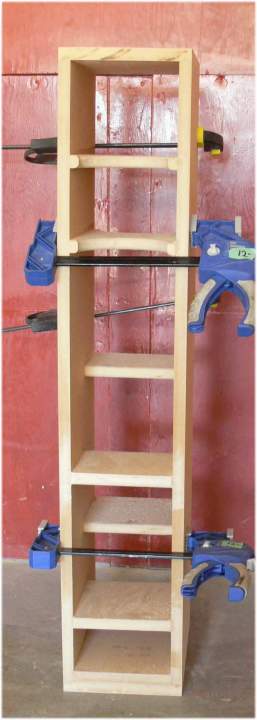

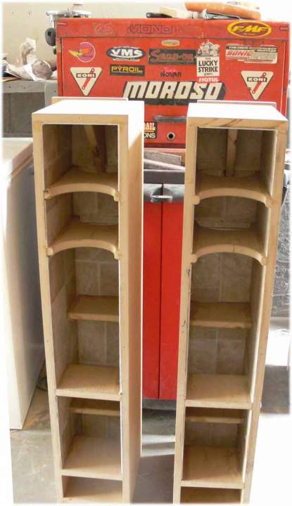

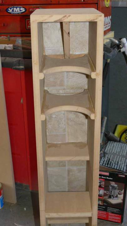

Here's how they are looking now.  I'm pleased witht he results thus far.   I obviously need to invest in more clamps  for future builds.
As you can see,  these are  front vented so the TL has been  flip flopped.

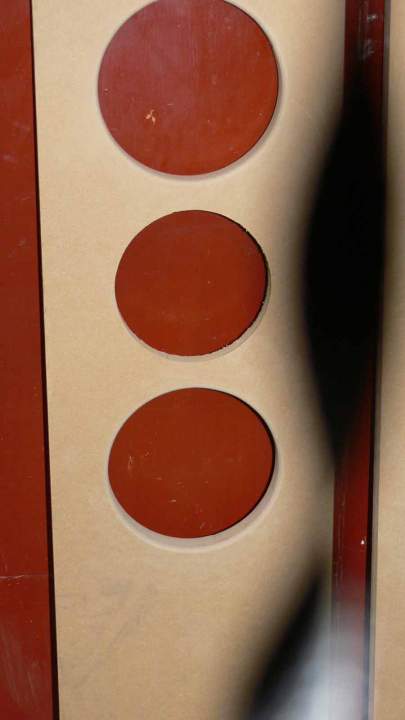

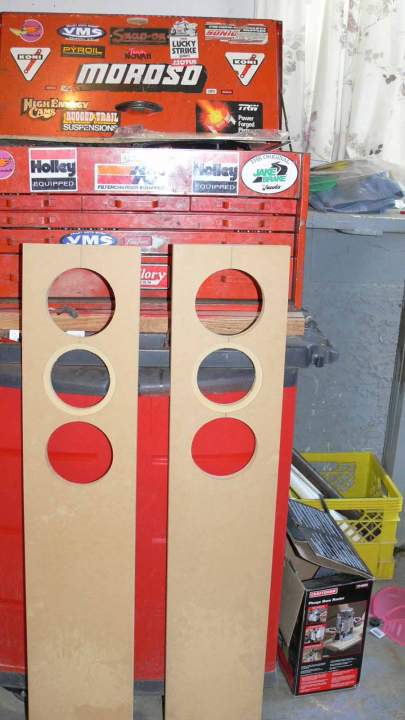

I was also able to get the front baffles  cut out.   The rear of the woofer holes  are rounded over with a 3/8  radius.

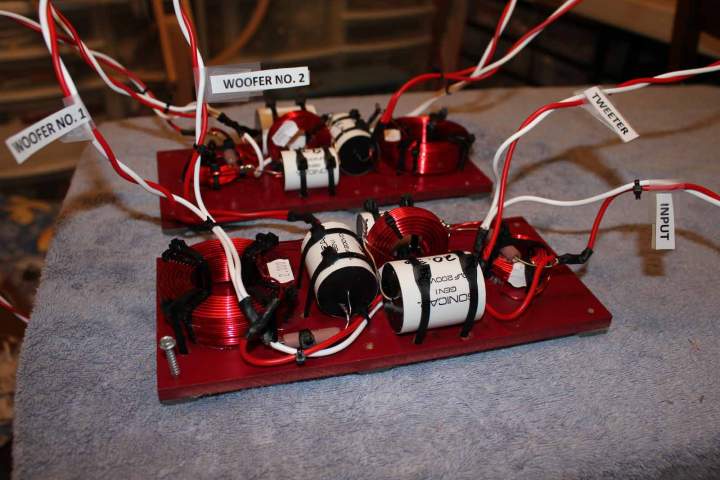

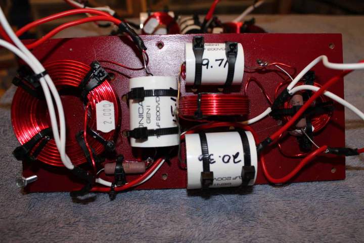

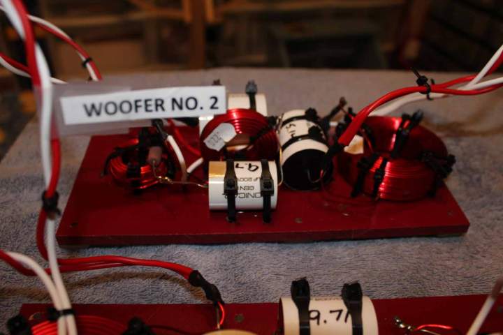

I received my cross overs from Ron  the other day.  Here are a few pics
Now looking ahead a bit and remembering that the TL is flip flopped, should I be  putting these  on the front baffle  right below the  2nd woofer  and above brace E ?   It's either  there  or on the  back panel between brace D and brace F   which would be a tighter fit. Is the placement going to effect the  TL?

Note to Danny.  I like how Ron labels stuff for the non technical minded.  This type of picture should be stickied somewhere for those of us who want to build speaker but don't care to learn how to read schematics.
Ron very kindly sent me a picture of his crossovers when I built my N3s.

« Reply #5 on: 9 Aug 2012, 03:15 pm »
I'd go with that.
Re: Starting my N3 build
« Reply #6 on: 9 Aug 2012, 04:49 pm »
I'd go with that.
I was originally thinking that too, but  was worried   it may somewhat block  that part of the TL with brace E (on the ront panel) in between  D & F.  It will fit there, but like I said, I am just a bit worried about it blocking the TL
Danny Richie
« Reply #7 on: 9 Aug 2012, 06:38 pm »
That part of the TL is large and air flow is not going to be inhibited.
