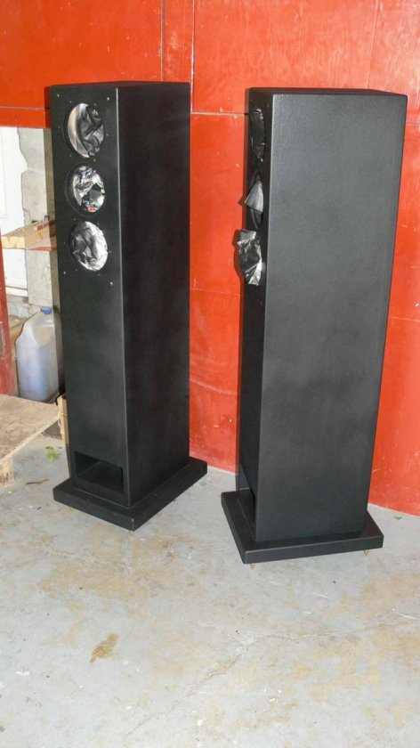

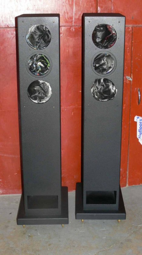

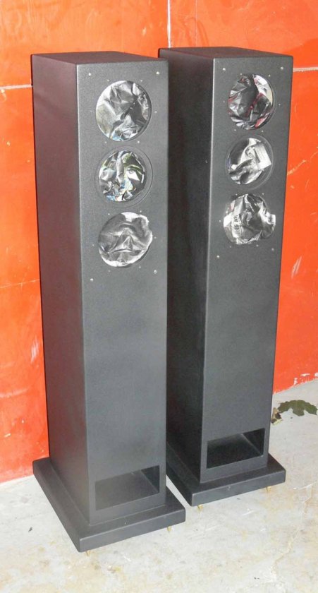

Well,  after a weekend of many blunders,  I finally  got   these cabinets  painted this morning. It was all supposed to be done   by Sun eve but   that just didn't happen.
Inded up  finally spraying them with the  Home Depot  truck bed liner,  the same stuff I used on  my sub. It isn't rubbery  at all  and   gives a nice satin black, lightly textured final finish.  The TBL  sprays on surprisingly thin and soesn't hide  imperfections  as well as you'd might expect so  getting the cabinets prepped well is key.
After spraying them  with   2 coats,  I'm  pleased with how they turned out.  Here are a few pic...
Going to go work on getting the  xo's mounted to the access panels and installing the elecra tubes
-jay

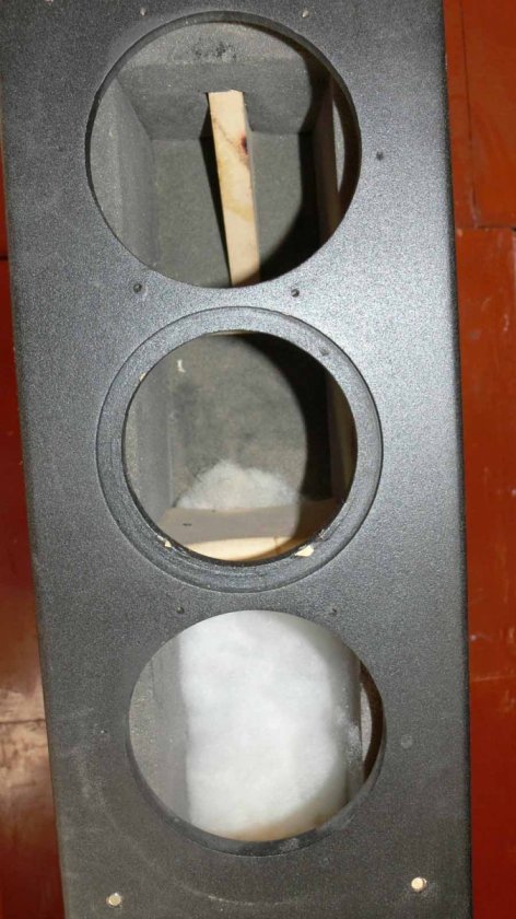

Got a quick question about the poly fill  behind the top woofer and the tweeter....
I can see from the diagram where the poly fill needs to be but   how loose do I  place  it in  there ?  Just loosely fill the  chamber  ?
Also,  I'm  assuming that the  rear holes in  the br ace B's get covered up with poly fill  ?
Thanks guys
-jay
Ron
Re: Starting my N3 build
« Reply #67 on: 14 Sep 2012, 12:14 pm »
  I recommend lightly filling the back half of the cabinet with poly-fil. By lightly filling I mean the poly-fill should be fluffed out and not compressed.
The rear hole in the brace will be covered but this is not a problem.

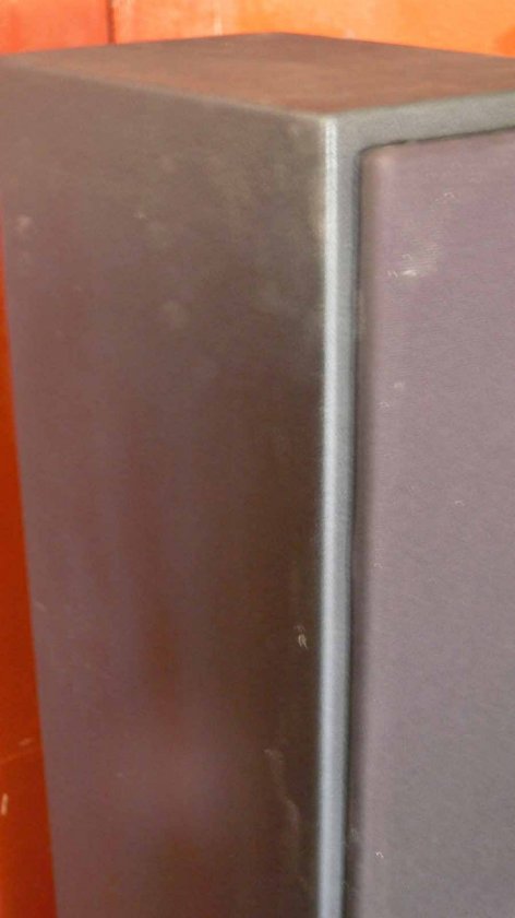

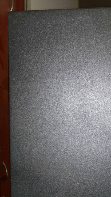

any chance we can get a close up photo of the finish, maybe under a couple different lighting scenarios...?
« Reply #71 on: 16 Sep 2012, 11:49 pm »
Here's  1.  I  tried to get more but my  battery died in the camera.  I'll get a few more later.  It's tough to get  many different lighting  conditions in the garage,  it's either flash or no flash
The finish is quite textured.  When you run your hand over it, it feels like say a  very worn  sheet of 240 grit sandpaper.
There are also a coule shots of my sub in my gallery that show it not too bad.
-jay

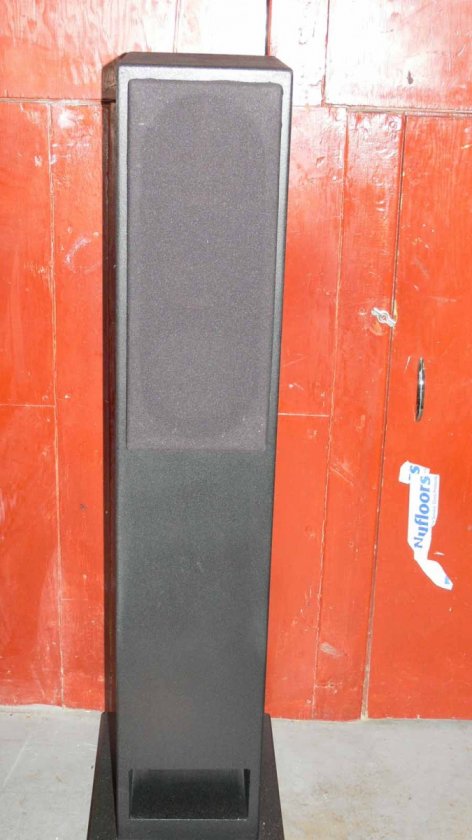

And here is my first attempt at  a grill.  The front side definitely looks better than the backside !  I used contact cement to attach  the cloth and found it difficult to keep things neat .  Hopefully I'll do better on the next one.
-jay
