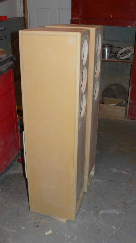

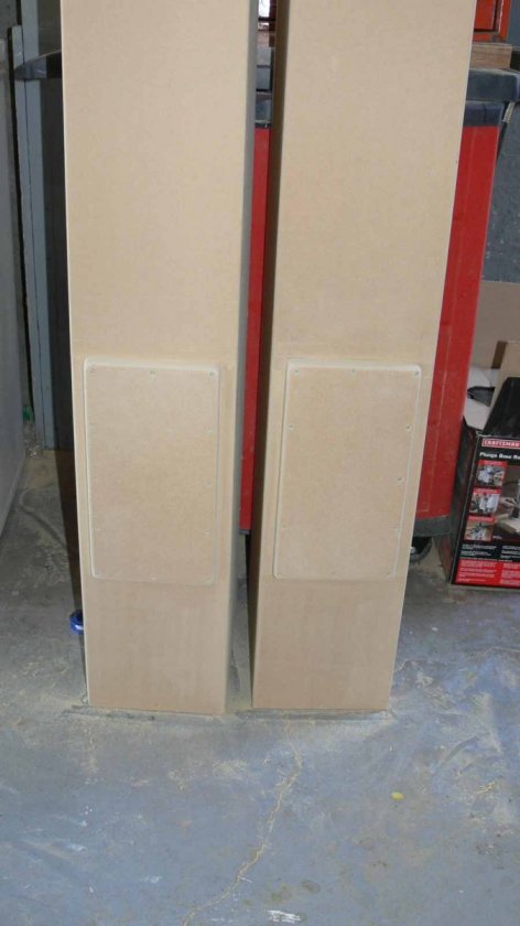

« Reply #46 on: 30 Aug 2012, 11:44 pm »

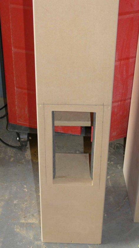

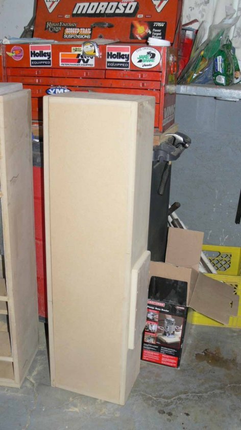

Ok the crossovers were just  a bit too big  to fit  behind the lower woofer.  With brace D  being on the rear wall   due to the front vent design,     the space behind the lower woofer  is smaller than  normal.
I really didn't ,ike  the idea  of making the front baffles remvable  but I also didn't want to  bury the c/o's   leaving no access.
So I decided to go with an acess panel on the rear wall.
The  panels will be  large enough to  hold the c/o and the electa tubes.
Here they are installed  and rounded over
The panels were made from 3/4" MDF .  After they were fit in place,  I  glued  lino to the inside face.  C/O's will go on top of that.  This was kind of an unexpect hic-up in the build but I think it will look ok  once the cabinets are painted and it will make accessing the C/O's  pretty easy if ever need be.
I also did a 3/8" roundover on the  rest of the cabinet.  I've been condidering doing a 1/2" roundover  but  am not sure  .  Leave it as 3/8 or do the 1/2  ?

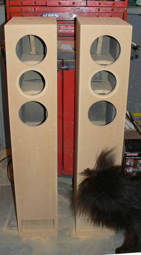

Re: Starting my N3 build
« Reply #51 on: 1 Sep 2012, 12:39 am »
Man! that's looking great. You have been a busy boy! I did the 3/8" roundover too, but I think I am going to do the 1/2" on mine. On yours I think the 3/8" is probably better. Mine are chunky little boxes, narrow and deep, and I want the bigger radius look. Something like this http://audioengineusa.com/Store/Audioengine-A5
Larry

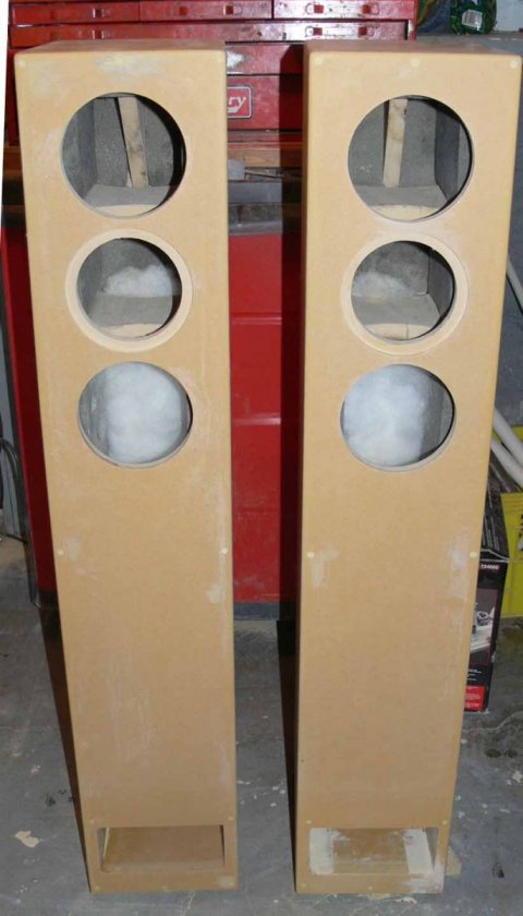

Hey Larry
Yeah,  things are  moving along  pretty good right now (knock  knock).  I did a 1/2" roundover on  my sub and it looks pretty good .   I'm still not sure   if I'm going to stay  with the 3/8 or go to the 1/2,  the basses are  quite thick and I think the 1/2 would look better  on them but I really don't want mix the two.
Got one of the front baffles glued on this afternoon.... I can only do  1 at a time,  need more clamps.
Not sure  I will get to painting this weekend but hopefully  I'll at least get them primed.  we'll see.
-jay

Hehe,  no my joints weren't perfect.  I had to do some filling and sanding.  I used some wood filler my  father reccomended.  I also used it on my sub and it  has stayed in place well thus far.
I was actually just planning on  a couple coats of  primer  like I did on the sub followed by a couple  coats of  the truck bed liner.
Unless a guy is going to try and seal the entire cabinet like you  are talking about in your build thread,  I don't really see the point in  just doing the outside.  I would think  that the TBL over the primer is going to seal  the ouside just as well ?
-jay

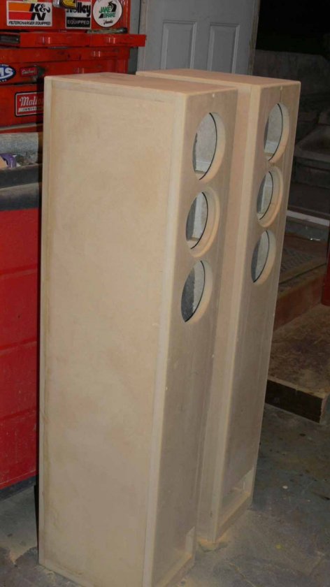

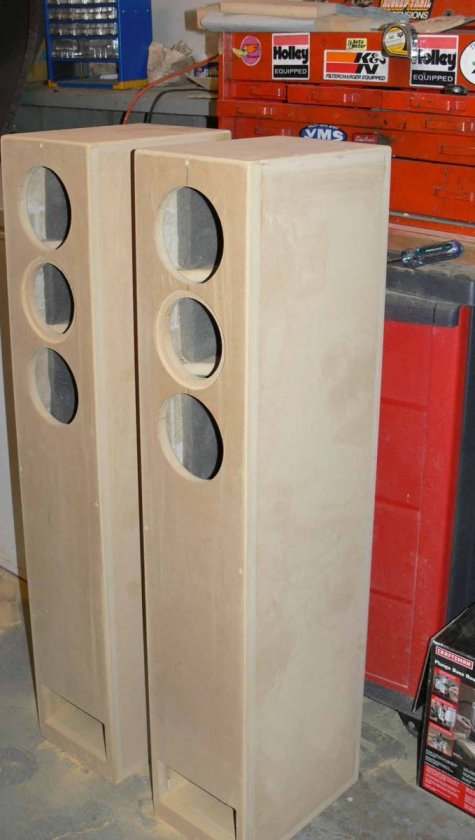

« Reply #54 on: 4 Sep 2012, 05:56 am »
Well,  I didn't make it to primer  but I did get  quite a bit done this past weekend.
Spent the better part of a day filling screw holes, low spots,   and sanding.  It was a lot of work.   When I glued the front baffles on, I   drilled quite a few new   screw holes  to make sure  I got  them good and  tight.   I only  have  four clamps so  screws were the  only other option.
I've been following Larry's LS Encore build thread  and all the talk  about sealing edges  got me a bit worriee as I had only planned  to  use a  couple coats of primer  followed by  a couple coats of truck bed liner.  Anyway,  I decieded   to "seal" the  cabinetsc using a ouple coats  of  a wood glue / water mixture (75/25) before   applying the primer  After each  coat  I lightly sanded with 400 grit paper..
They have come out really nice  .  I hope the glue mixture does a  good job of sealing up   the edges and the rest of the MDF for that matter.
This is where they  stand now..
I'm glad  I  did this "extra step"  now that  it is done.  Maybe tomorrow I'll get  a couple coats of primer on.
I also  got the grills  cut and routed out  over the weekend.  Had a bit of a mishap  when my Craftsmen router's  plunge depth  setting  slipped   which was a bit frustrating..  Appareently the aluminum body   (where the set screw  is tightened)  has  stripped .    This particular router  isn't even  a coule months old so I'll be taking it bak to Sears  and  trying to have it replaced
I was able to save the grill  so no real harm was done but  it's still frustrating.
 Still haven't decied whether to leave the grills square with roundovers  or  go with the oval   shaped grills.  I like them both.
No pics fo the grill frames yet, will try and post some tomorrow.
-jay

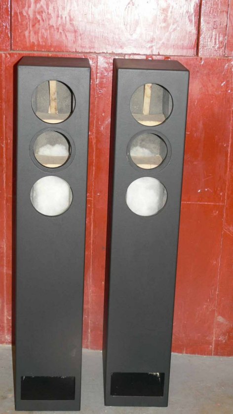

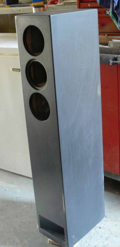

I put on 2 coats of flat black primer.  Sanded with 400 grit  between coats and after 2nd.   Still a couple little spots to work on but  just about there.
I'm still  planning on using the truck bed liner  for a finish.  Now I've used the spray on  liner from a spray bomb but I was wondering if anyone has used the roll on  typre.  I am actually considering trying  the roll on  as I assume you'd get a lot more texture
Any thoughts regarding  this  ?
-jay
