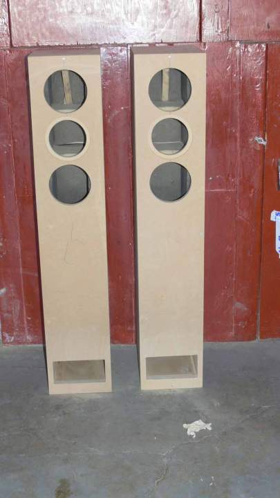

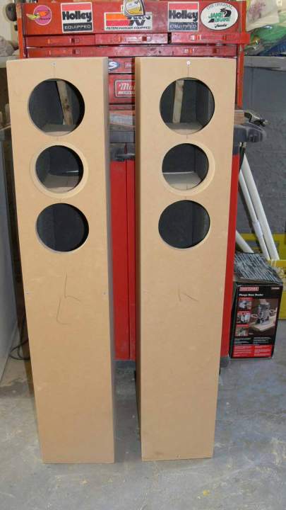

Well, I didn't get a whole lot done this weekend.    I did finish  gluing in the foam so that is out of the weay.  After getting that done,  I decided to roughly  fit and sand  the fron baffles .  When screwed in place they actually came out pretty  close   Not to much sanding was required to get a decent fit.  All the edges have had a  first sanding.
Now,  I'm going to be using fiberglass insulation  for the   " stuffing" in the areas shown in the plans.  What I'm wondering is  how  thick  should the insulation be in the areas indicated above brace "d" and brace "e" ??
Also, when I get to the  point wher I'm  putting it in behind the woofers,   do I need to make sure  that the   semi circle openings in brace  b  is kept clear  or do I  fill with  insulation  right over the openings as  it is kind of shown in the plan ?
I've got to get the  vent openings cut out.  I ordered a cheap flush trim  bit   from China .  Usually delivery  from China has been bery quick in the past but this seems to be taking a little longer, hope it shows this week.
Next build I do I'll make sure  I do all the cutting/fitting before  gluing in the  vinyl/foam.
-jay

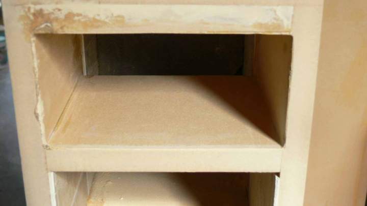

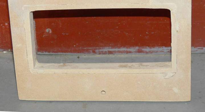

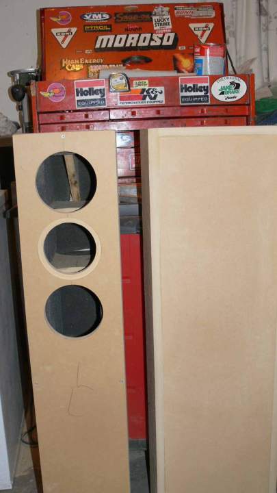

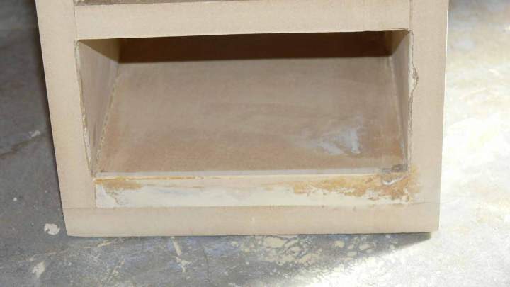

Here are a few pics of the  vent and babble repair.    I'm actually not expecting the baffle repair to  work  as I don't think it will holld up to routing. The baffle  has had all four edges "replaced" ajnd thus needs to be  routed with the trim bit..  If it sdoesn't hold up ,  I'll be cutting a new baffle.  I'll probably just do that any way but it will be fun to see if the repair can hold up.
The vent  will be fine.  Another coat of wood putty on each side and we should be good to go again.
Here it is right side up.
And from the bottom (upside down)
I'll try routing it tomorrow and see what happens.
BTW, I never did find the screw that fell out of the  bit  .  However, I pulled out my  old RC helicopter  parts bins and found a small screw that fit so I have a bit again :)  Used Loctite and  crankded that little screw  as tight as  I could .
« Last Edit: 25 Aug 2012, 06:46 pm by Captainhemo »
Re: Starting my N3 build
« Reply #38 on: 26 Aug 2012, 12:33 am »
The repair held up fine to being routed .  I was surprised as I figured the  pieces I glued in would have  just been torn out by the router. Stron bonds..
