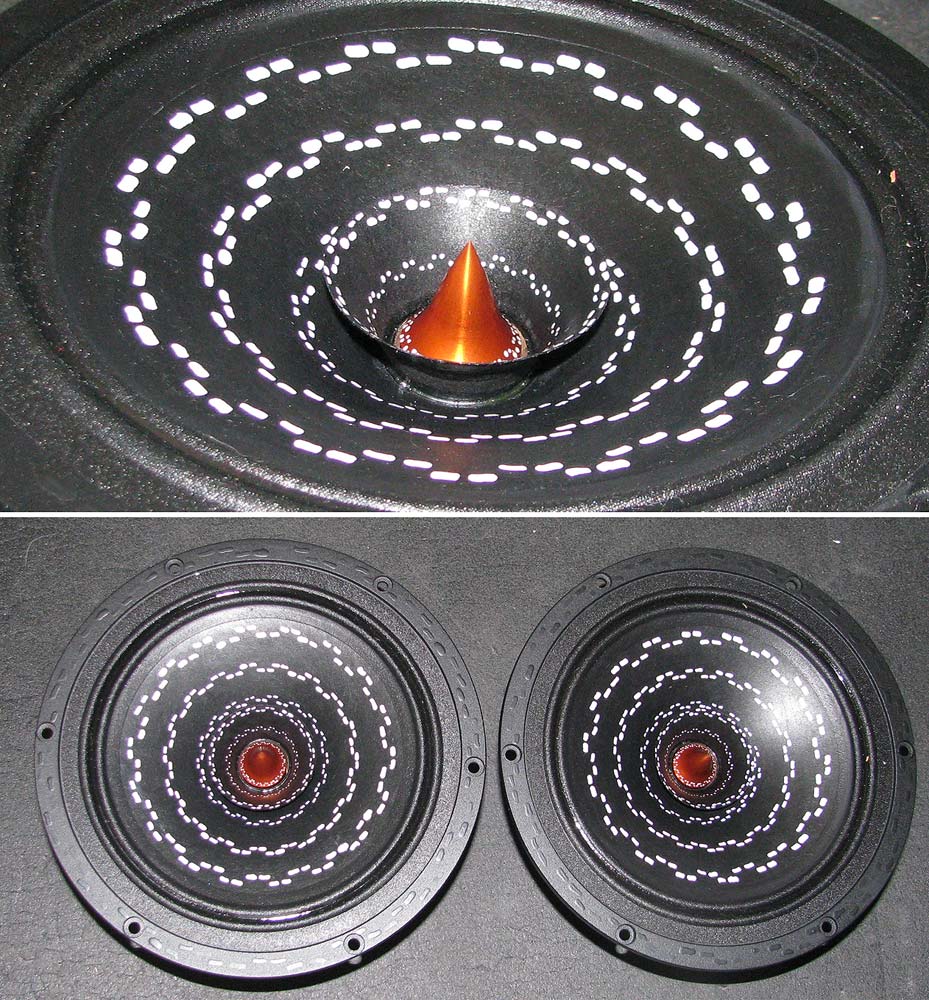

the Dayton Audio PS220-8 8" Point Source Full-Range Neo driver (quite a mouthful) crossed over with the 15" Eminence Alpha 15A
That Dayton is quite good. Benefits from some tweaks.
My experience with the Eminance is not near as posisble. Many seem to like this woofer, i find its performance comserite with its low cost.
