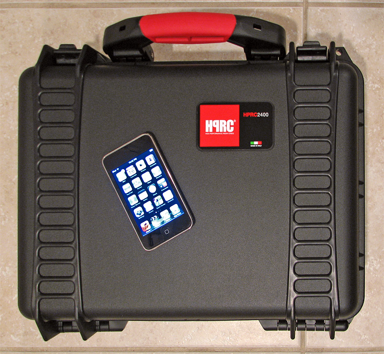

Resurrecting this post after two months of silence...
Here are some photos of my "transportable" rig that allows me to travel with the MG3 and a pair of Audeze LCD-2 orthoplanar headphones.
First, this shows the rig set up on a table, but with heavier gauge speaker wire (10AWG, 462-strand OFC) that I had to downsize for use in my travel case:
And here's the rig in its case:
44.1/16 and 96/24 WAVs on multiple 64GB MicroSD > Sony PCM-M10 Line Out > 24VDC-powered TBI Audio Millenia MG3 (~5.1 Watts into 50-Ohm) > TBI Impedance Match > Audeze LCD-2 rev.1
1)  Open the case
2)  Connect headphone cable to the LCD-2's mini-XLRs
3)  Connect the 24VDC LiPo battery and attach alarm/monitor
4)  Connect interconnect cable to Sony PCM-M10
5)  Turn on the TBI Audio Millenia MG3 and listen to music!

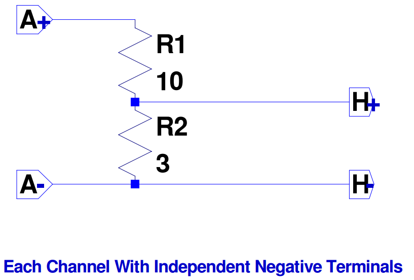

Jan Plummer (of TBI Audio), built the impedance match to reduce the hiss caused by excess gain when plugging the Audeze LCD-2 directly into the amp's binding posts.  Audeze technical support says the LCD-2 can handle output from amps rated as high as 81 Watts rms per channel into 8-Ohms, but I was hearing a low level hiss prior to getting the impedance match.  Now - it's perfect - and the sound is amazing!
Here's a schematic Jan provided showing one channel of the resistor network ("A" means Amp, "H" means Headphone):
I believe this idea of using the MG3 with headphones, via an impedance match, was pioneered by a member of Head-Fi.org who goes by the handle "SMG52."
Mike
