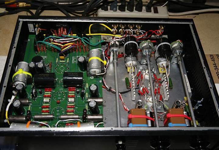

PCB assembly was a breeze, Clarinet’s side took a bit more time but overall actual assembly took a lot less time than I’ve expected (even though last time I’ve used a soldering iron was probably about 20 years ago). Here is my completed project:

Currently there are only two green ground wires (as per instructions) connecting CORNET board to a single grounding post. There is only one grounding post for both sides where all grounding wires are connected.
CORNET's input goes straight from the input RCAs to the board with a shielded twisted pair with one side of the shield connected to the RCA's shells and other to the board ground (center hole of the board input connector).
Output goes from the board to the input selector switch using same shielded twisted pair wire with one end of the shield connected to the board and the other end (at the selector switch) is floating. This wire does go next to the transformer wires and may act more as an antenna rather than a shield...
CLARINET (p2p) side has a grounding bus going from H+ filter to heaters grounds and then to the grounding post and separate grounding wires for each of the following (one per channel): B+ filters, R302/R310, volume pots, R312. All wires connected at the single grounding post.
If I had CLARINET board I would definitely go with original CLARICORN design with a power supply on CLARINET side (or more likely just build separates). But since I only had CORNET board I used it for a power supply and I switched sides to keep CORNET's H+ rectifier and filter further away from CLARINET side and inputs.
