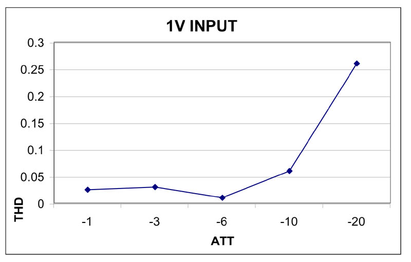

Re: Can Someone Please Explain "Hearing A Volume Control"?
« Reply #23 on: 13 Jul 2012, 03:35 am »
There I knew I could find it if I bothered to look for it. Here is the distortion plot at 1 volt in, most CD players put out 2volts. The distortion is primarily 3rd harmonic according to Nelson.
Nelson Pass's comments from diy Audio  "Lastly, here are the distortion figures I got with a constant 1 volt input to the attenuator. More input voltage naturally results in
greater distortion, except at the -6 dB value, where the 3rd harmonic
distortion of the two LDRs cancels. From -1 to -6 dB, the distortion
is compressive, and from -6 to -40 dB the distortion is expansive.
Here is a link to the complete thread.
http://www.diyaudio.com/forums/analog-line-level/80194-lightspeed-attenuator-new-passive-preamp-134.html#post1520950
Scotty
