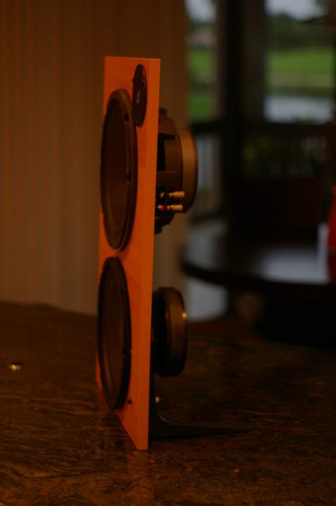

Hestia Prototype
« Reply #12 on: 11 Jul 2012, 12:12 pm »
A few pics of the prototype:

Yes, the coils are just attached with a strip of velcro for now to test the prototype. The finished board will have the smaller inductor flipped on its side and zip tied to the board.
