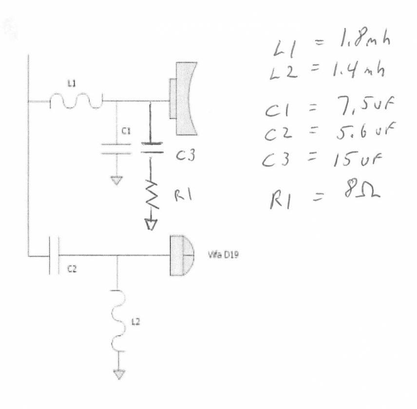

Hestia Crossover Mod #1
« Reply #87 on: 9 Oct 2012, 05:30 pm »
One interesting permutation of the Hestia design is to swap the location of the LF and Mid drivers to produce a more forward sounding and prominent mid range. The Dayton's slightly higher efficiency may also be a better choice for those looking to drive the Hestia with a SET amp. (Overall efficiency raises to about 92dB)
Without a crossover mod, the Dayton Pro Sound driver sounds too proud as a dedicated mid range within the context of this project. The mod referenced below provides a notch in addition to addressing a rising impedance condition which may otherwise be an issue for tube amps.
I now have two sets of Hestias configured each way... Both sound great but with slightly different tonal characteristics. The cool thing is you can try both options without having to change drivers or baffles, for just a few bucks in reisitors and caps.

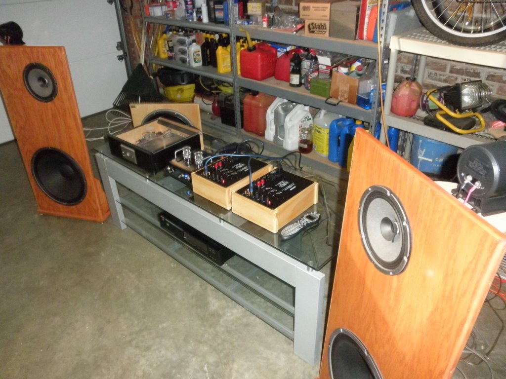

Hello everyone, I am new here.
I was just browsing to see if anyone else had done a project with these drivers from MCM.
Glad to see it was an OB design as well. The Hestia project caught my attention as I have a pair of speakers currently using the 55-2981 drivers but for the low end in a very large ported box with the mid being OB.
I was contemplating about using the driver for mid purposes as well in a OB replacing the current top I have. When I saw this It got me thinking it might actually be probable. I would however need to make the baffle larger on top but still make it look nice.
heres a pic of the project while being constructed still.
also the bullet driver has been replaced with a Vifa dome (don't have the number off hand but I know it was used in the orient express by Zaph Audio). As I had not liked the sound/ harshness of the bullet.
The project is crossed currently with a cx3400 but hoping to swap that out soon with a dbx or digital unit as the current active crossover has some quality issues.
I am really interested in using a plate amplifier with these if I converted it to a half passive/active setup. With the top being the top half Hestia design. Thinking about using the PSC2.400 by hyphex.
any questions comments or concerns please inquire.
I would also like to note that the drivers from MCM have changed to a different model/design. The RMS is lower the cast frame slightly different and the paper cone almost looks identical to the Dayton shown here. I have
no idea how these sound as I have not tried or tested them in any way. Just a heads up.

Hi Lynx,
Thanks for sharing your design. Some similarities between what you have done (and want to do) and the Hestia. I havent had a chance to hear the Hypex plate amps but understand they are nice. I've been very favorably impressed with the Yung models sold be PE. I have moved that to the top of my list, previously reserved for the Bash amps. The Yung are at a slightly lower price point and appear to have the edge on quality as well. I am on the fence between models with and without boost for OB. This may depend on the particular driver more than anything else, but a switchable boost would be a nice feature.
Completely agree with you about quality issues with several Behringer crossovers. I've played with many over the years and really like the dBX 223 and 233 series, as well as most of the models by Ashly. Not completely sold on the Driverack models, or many other all digital x/o's for that matter.
I've been talking to someone on another site who is building a slot loaded open baffle sub using 6 of the MCM select drivers. He bought both the 10's and 12's. His order for the 12's were mixed, both old and new, while the 10's were all original, the same used in the Hestia. He said the thickness of the cast frame has been reduced on the new drivers (i.e., cheaper) but the T-S parameters were similar. The cone design has also been updated. Hasn't had a chance to do much more than  test them at this point.

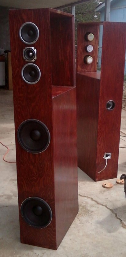

Finished up a set of Hestias about a week ago. They sound great. I flush mounted the drivers which took quite a bit of router time, but overall a straight forward project. Also, I moved the mid/tweeter combo higher on a taller baffle closer to ear level. The sound between the HF and LF is very cohesive despite the gap in between.
Matevana if it is not akin to asking the alchemist how he makes gold, would you mind describing the process you went through to design the crossover?
And also, what's next?

Thanks for the compliments. I found some edge glued panels of three or four inch boards at one of the big boxes. The wood wasn't special but I liked the patten of the boards and I wanted them to pop a little. The idea was to stain the panels and then finish with a high gloss. But they came out basically red. They aren't as red as the photos show, but when the lights are low and the tunes are playing its all good.
I haven't lived with a subwoofer. The Yung amp can make the floor shake, but of course that isn't the same as LF extension. I have a sub box half built in the shop so maybe I'll have to get that finished.
