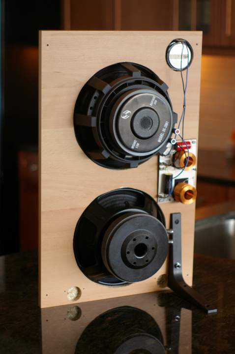

Neat project. How bout some rear views?
matevana
Re: Hestia OB, an ambitious low cost, 3-way OB design
« Reply #31 on: 15 Jul 2012, 08:22 pm »
Hey Poultry,
Here's the butt shot you requested  :thumb:

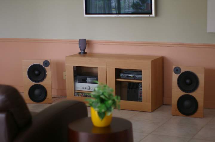

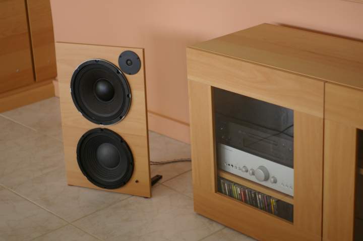

matevana
Finished Pics
« Reply #33 on: 18 Jul 2012, 05:54 pm »
Here's a few pics of the finished pair w/matching Audio Cabinet.
