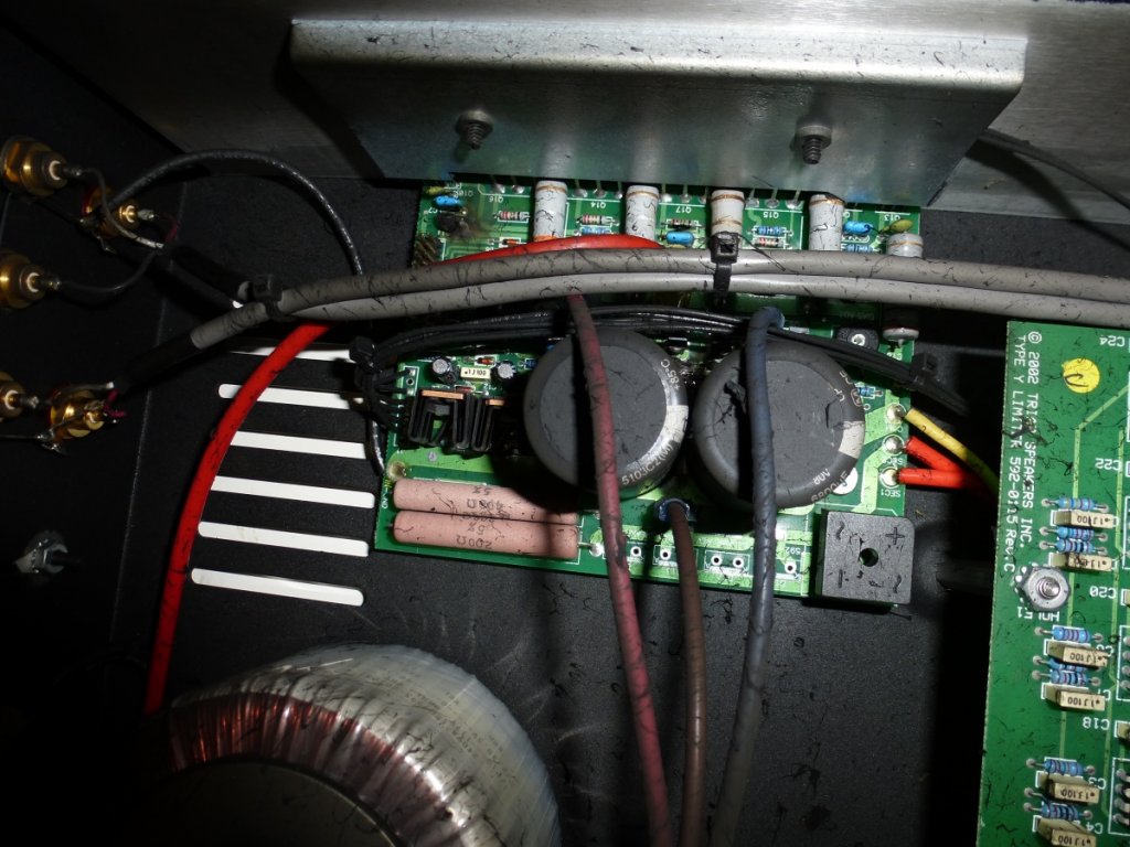

The pictures looks like a power supply board fried? Did it fry itself or did the output device(s) short and take it out too? I'm surprised it's non-repairable or a newer Ice amp isn't available?

The fried section is the left amplifier board. Based on the pictures, he said any time he has seen that much damage, the traces on the board are damaged and they no longer have replacement amp boards for this model.

Here is a photo of the other working Maestro amp that remains in my rack at the moment.  Apologies in advance for the quality of the photography as I snapped this on my phone.
