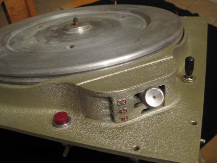

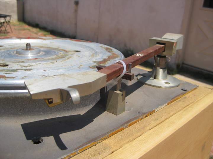

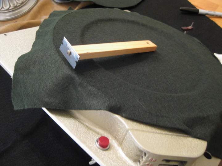

I thought I'd post some photos of a rebuild I started a couple of weeks ago.  This is a Collins 12S professional turntable, salvaged from a local country/western radio station.  The wiring was burned up, but most of the rest was close to operational.
Ugly crinkle gray paint, a wooden tone arm with a fixed counterweight

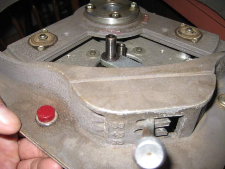

Three speed transmission.  Reminds my of the column shifter on my old 63 Ford truck.
Cleaned and repainted
cutting the felt

« Reply #1 on: 17 May 2012, 04:02 am »
Very nice and I learned something too. A razor blade attached to a trammel point for cutting the felt all neat and round.

« Reply #2 on: 17 May 2012, 02:50 pm »
Thanks AE.  It did turn out pretty nice.  I learned to glue the felt before cutting, otherwise it bunches up and cuts unevenly.  It will take a while for all the various parts to come in, but I have high hopes for this old thing.  If it turn out that that it is still rumbley, I can either use a filter, or sell it in Japan.  There is a very strong demand for them there.
Oh yeah! The ole "Three on the tree."

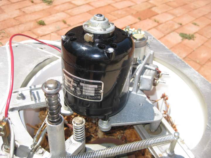

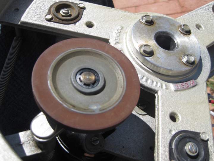

« Reply #6 on: 17 May 2012, 04:47 pm »
Cool, any pictures of the underside? Motor images?
How did you refurbished the idler?

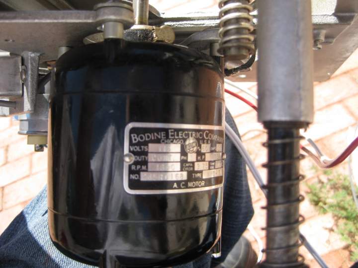

I found a source for idlers for $36, so even though the old one is still pliable, I'll pull it and keep it as a spare.  The motor is a Bodine, which my friend Gary Dodd tells me was a high quality unit in its day.  I spins very quiet with little vibration.  I should have a new idler and new motor mounts within a week, and a new ceramic ball bearing sometime... coming from China.  Enough chat. More pics.

« Reply #8 on: 17 May 2012, 08:59 pm »
Awesome, that motor looks like it would spin a car. :)
It is about the size of a starter on my Honda Goldwing.
Can you please share your idler source? I'm working on an old deck as well.
russcoturntables.com  The fellow's name is Skeeter- full time DJ, nice guy, and part time turntable nut.  It may be easier to call him as he can be slow to respond to email.
