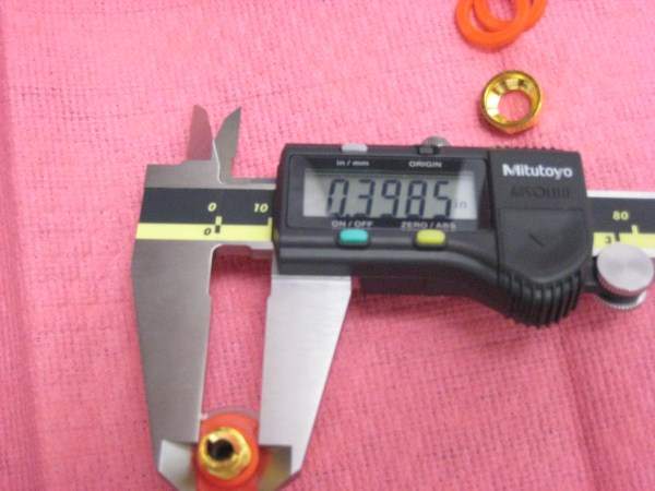

I'll measure insulator diameter (Apex did not know).
10mm if you want exact or 25/64".  This is what mine were and what the program is made for.

I will post pics tomorrow of the Apex binding posts with measurements....

James
Here are the pics showing the insulator size on the Apex Jr. Short Binding Posts.

« Reply #89 on: 18 May 2012, 04:55 pm »
Jason,
Thanks a ton.  You removed the last hurdle, as long as the other items have opening dimensions online, which I presume to be the "case" (as in "chassis"...no pun intended).
