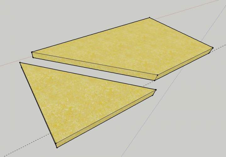

Owens Corning 703 Rigid Fiberglass, 2'x4'x2":
703 cut for super-chunk bass traps:
703 cut for super-duper-chunk bass traps!:

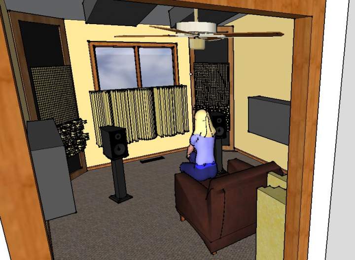

« Reply #13 on: 31 May 2012, 04:23 am »

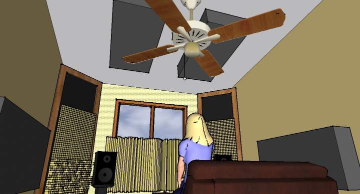

View of the treated listening room from the doorway:

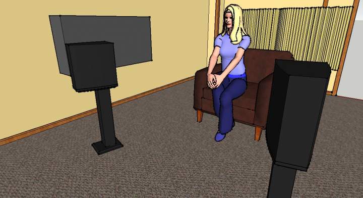

My very attentive listener? Who doesn't believe in the sweet-spot but prefers the edge of her seat?:

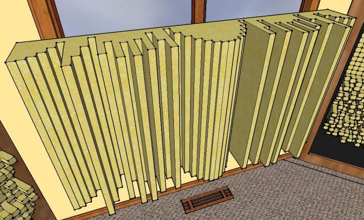

View of front 1D quadratic diffuser:
Design is from QRDude based on prime 53, effective down to 565 Hz. Boards are 1.2" thick (the actual thickness of 1.5" lumber, the narrowest that can be bought that is more than 1"). Period width is 4'5.

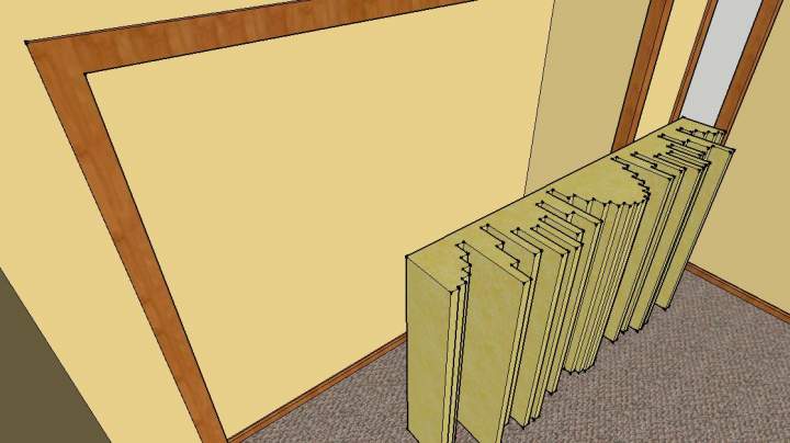

View of rear 1D quadratic diffuser:
Same design as the front. I wanted to use a bigger prime and bigger period width, but it can't be done if I intend to leave the room after it is installed. Unless I can change the door to swing out?

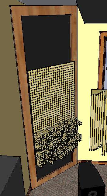

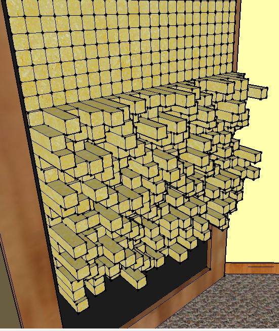

Front 2D prime root diffuser (unfinished model):
Based on the prime number 947, it is 22 rows wide and 43 columns wide (22x43+1=947, and since 43 is prime also, the only number both dimensions are divisible by is 1). Well depths were generated on http://www.oliverprime.com/prd/ with well depths quantized to 1 cm. It is effective down to 1,200 Hz.

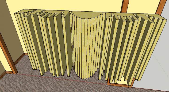

Front super-chunk bass trap:
Floor to ceiling Owens Corning 703 cut into triangles, 24"x24"x34". Covered with black fabric.

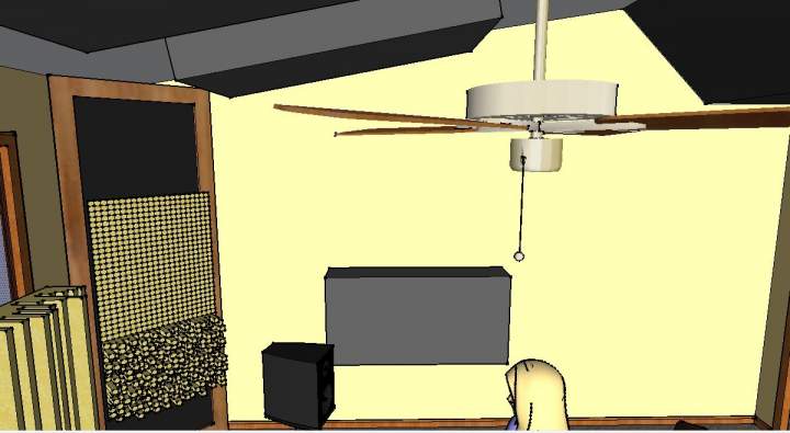

Rear ceiling super-duper-chunk bass trap:
It covers the back wall where it meets the ceiling. It is composed of Owens Corning 703 cut into a polygon the dimensions of three of the above triangles. Polygon dimensions are 24" height, 48" width, 24" on the top with a 34" slant to the bottom.

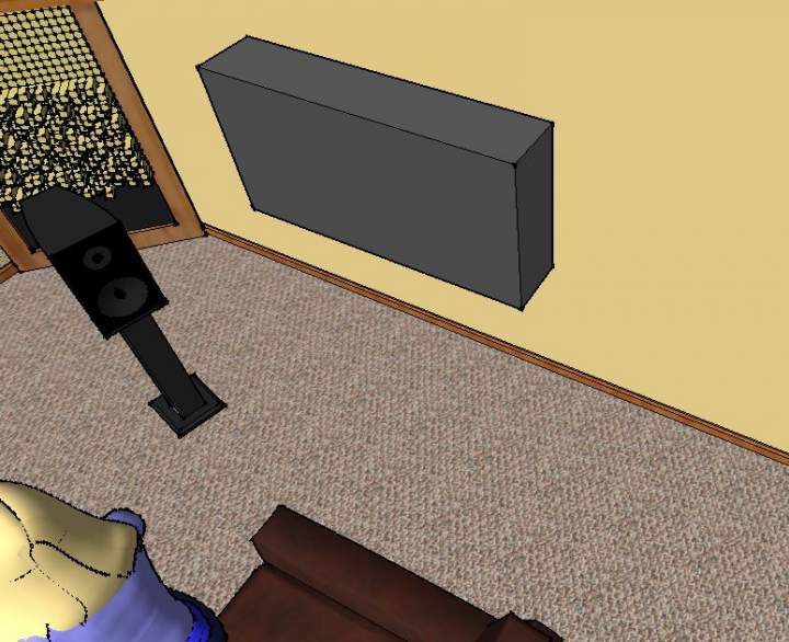

Side wall first reflection point:
It is a broadband absorber made from 4 sheets of 703 held together by fabric stapled to a rear frame. It is 8" thick of absorption held 1.5" out from the wall by the 1.5" wood frame (which doesn't cover the entire back of the panel, only around the edge).

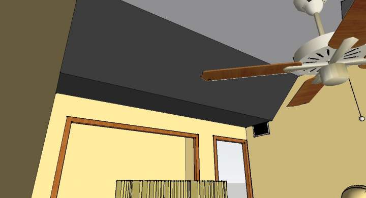

View of the sloped ceiling:

youngho
Re: Home Shopping - How's this for a listening room?
« Reply #14 on: 3 Jun 2012, 03:37 pm »
Hi, a few thoughts from me:
0. Sorry, I think the room as modelled would be unattractive.
1. Front window: instead of diffusion, you could make two absorbing panels using 2x4 framing and rigid fiberglass panels, covered with cloth. These could be sized to the windows and mounted on the frame, basically like shutters. This would be less visually intrusive, if that matters at all. Later, you could try replacing these with custom RPG BAD Panels or Arcs to see whether you prefer the center diffusion or absorption.
2. Corner traps: I wonder if someone could point me to good data regarding the Superchunk method, as the little I've seen has not been convincing? You may better off building a diaphragmatic absorber using thin plywood, framing, and fiberglass (perforating the plywood with a grid of holes would make it more like a Helmholtz absorber but could also be worth considering). Some measurements and math would be needed. Gearslutz and studiotips.com has some information, as does Alton Everest's acoustics book. You could also use something like I describe in #3.
3. Sidewall absorbers: Instead of an 8" thick absorber, I would consider 3-4" rigid fiberglass with a 1/4" airgap in front of a (possibly perforated) plywood panel mounted on framing, then either fluffy insulation or another rigid fiberglass panel with a little airgap. If you do use the fluffy insulation and are feeling creative with a band saw, you could build these so that one side is deeper and the other shallower so that the depth of the cavity behind the plywood is variable. If you made a bunch, you could mount a series of them on each side wall (deeper towards the front of the room, shallower towards the back) and have a reasonably attractive setup, like a lower-end version of http://www.avguide.com/blog/robert-harley-visits-transparent-audio-and-discovers-210-miracle-upgrade.
4. The rear: I would aim for symmetry, hence 3-4" thick absorption on the room door and the left closet door, maybe diffusion on the right closet door--something like the RPG BAD panel would work (you could drill the pattern through the door itself and put fiberglass in the closet behind the right door/panel, then use the other side for storage).
5. Ceiling: make sure you use a mirror, as the slope of the ceiling makes it a little trickier. 3-4" absorption would be fine, 8" is frankly overkill. You might consider the use of some diffusion on the ceiling.
6. Floor: The pictures suggest thin carpet. You might consider a thick fluffy rug or carpet between the speakers and the listening position.
