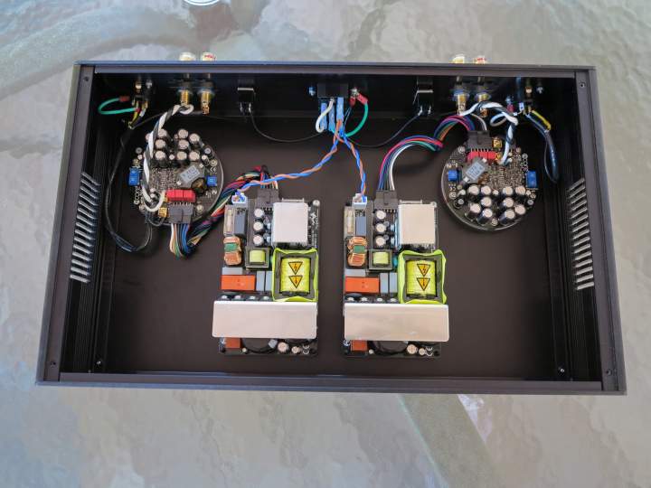

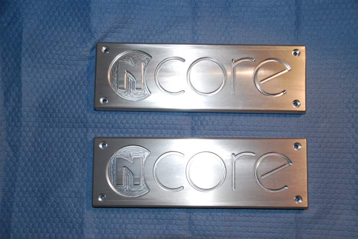

Yes it is absolutely possible.  However, it does add cost.  When looking at a complete build like this, you've got to wonder given that the modules are not crammed into the chassis if it is going to honestly make a difference?  One idea I have had was to have extra top plates made with an Ncore Logo CirclN punched out with small holes.  This could be orderd after the fact and would add a nice look.  I'm just not sure how many options people are really willing to pay for?  Currently I have a Laser Logo Front coming and am exploring other options like a milled front.
Here is a pick to give you an idea of how much space is in a standard size chassis like the dual mono.

If you just want some form of reassurance all is well, but not necessarily for aesthetic purposes, the amp modules have an array of LED's that light up when powered.  I can see them through the vents on top of my chassis, so that serves for my own reassurance.  Power lights on the front would be nice for my setup, but I'm pretty sure for me it's not worth the hassle of working the chassis and such.

A follow-up question on those LED's on the amp modules...does anyone have a picture of them "on" with the cover off?  I'd like to see them as part of my case design planning to get my cases built before my modules arrive.
