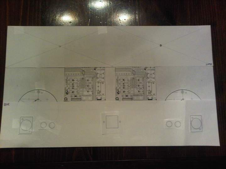

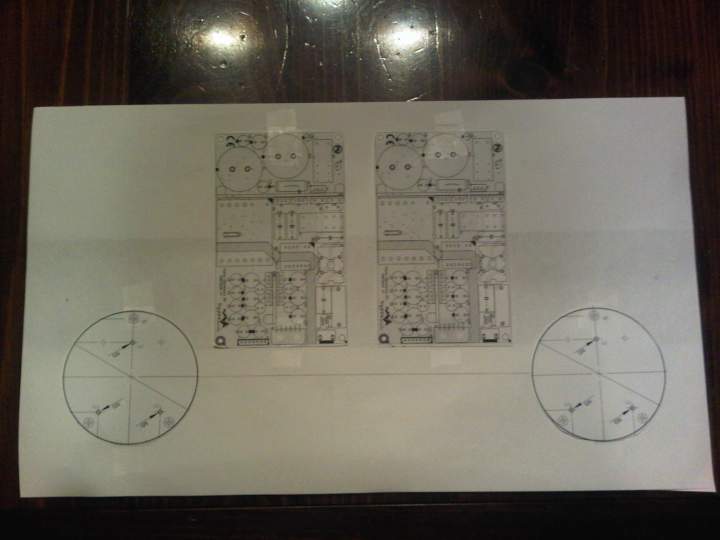

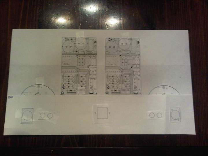

I'm working on my next Ncore Chassis.   :icon_lol: It will be a Dual Mono Ncore design.  The basic parameters are:
Black Anodized
17"W x 10"L x 3.47"H
2 Balanced or RCA Neutrik inputs
2 Speaker Binding Posts of common size
Here are some paper mock up photos

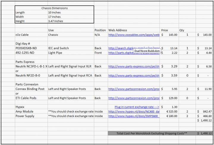

Here is a photo of a spreadsheet that you can use to estimate your total build costs
Here is a link to the spreadsheet if you would like to use it directly.  https://one-storage.com/eonapps/dl/BE78VKNB6NGFQDGUC6QCR  <--{You don't have to register just press the download link in the middle of the page}
Robert, a suggestion.
Consider changing your layout by arranging the right supply and board to be the same as the left pair (or vice-versa, depending on how you have the amp boards arranged).  Reason being is with the mirrored arrangement you have now, I am reasonably certain one of the wires bundle between the supplies and boards might  have to cross over the amp board.
Just a thought.
Just a thought.
Bob
Good ideas Bob.  I'm going to drill the right side amp so that it can be placed forward or backward.  That way people can choose if they want to mount the right side PS and Amp facing the front of the chassis and then avoid any cross over wiring.  I had other ideas like drilling the top of the case and mounting the right side upside down but decided that would be too unconventional.
