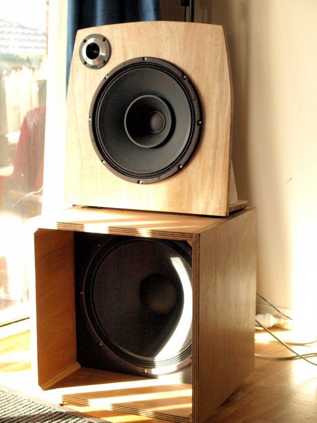

« Reply #79 on: 16 Jan 2013, 07:47 pm »
Hi Guys
My OB project is broadly similar, another take on a similar theme. Hope I'm not interloping here.
I'm using Hawthorne PSI 15 (which normally runs fully open in the Solo setting) and have a set of TAD drivers (2001s I think, from memory) that screw into the back of the PSI 15 so dual concentric arrangement.
Had been messing for a long time with series passive crossover but changed lately to miniDSP active crossover and instantly got better results (in half a day vs half a year of faffing with passives). By being able to reduce the output to the TADs I can get them to integrate more convincingly with the PSI 15s. The TADs had always seemed a bit sharp and I guess it was because they were just being more sensitive than the PSI 15s.
Im bringing the TADs in from about 2500Hz and letting the PSI 15s run to 5000. With LR24 slopes there's almost a straight line on the miniDSP crossover, with little in the way of dip at the point where the two slopes cross. I have no measuring equipment  so am doing everything by ear.
Just wondering whether I'm all at sea with crossover points. Would it be better to forsake the straight line on the miniDSP (ie, allow a dip where the two lines intersect) and let the Hawthorne stop at 2500, with the TADs taking over from there?
