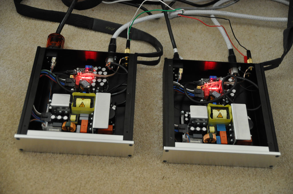

ajst2duk
Re: Show Us Your Core-NCore!
« Reply #70 on: 29 May 2012, 07:36 am »
Pretty standard simple build here - sounds good though :)
Dont squirm at the long signal cable length, I'm keeping it this way until I'm satisfied with the look & sound.
AJ

Don_S
« Reply #78 on: 20 Jun 2012, 10:11 pm »
My experience in general (not specific to NCores) is that there is always another level of "quiet".
The noise is already so slight that I can't help but wonder how any real improvement will be audible.
Don_S
« Reply #79 on: 20 Jun 2012, 10:12 pm »
AJ,
Nicely done.  Very clean looking.  :thumb:
AJ
