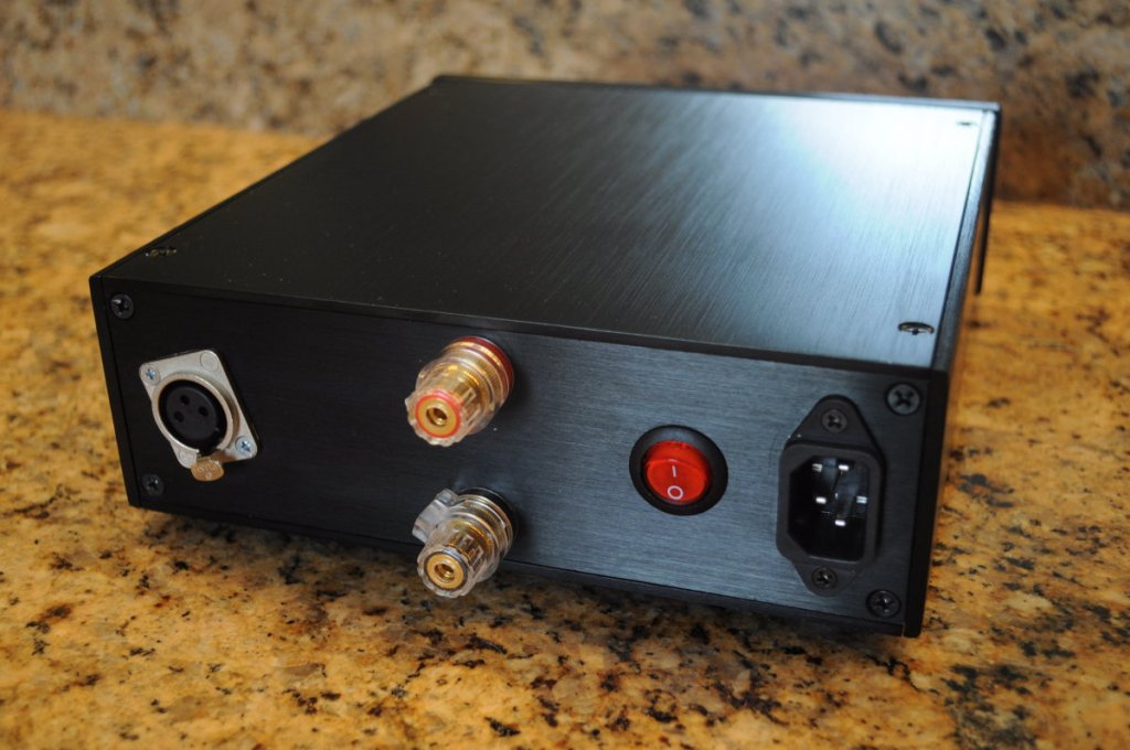

First monoblock is complete. Took a couple "glamour shots" that I thought I'd share. I may rework the power connections a little, otherwise I think it looks pretty good. Sounds good, too!

Do Siliconray still ship the same back panel with these enclosures?
I recall there was a second version with proper Neutrik fit and different binding post spacing.
That is the Siliconray case above; it was ordered in January but I had to wait for new cases to come in. As far as I know, that is the current back panel they are shipping (except for the power switch hole which I drilled).
As far as the Neutrik fit, I tapped the Neutrik holes to M4 threads, but I could not get the screws to thread because the holes do not quite line up. I ended up using M3 screws with nuts on the back instead.
It wouldn't be my ideal choice for layout (but it's not bad); but I imagine if you inquired with them you could get a blank back panel shipped instead. I may still inquire about getting a couple panels shipped and drill the way I want them.
You can indeed. That's what I did, see here

Thanks guys. So I guess there was no "official" update of the back panel design to fix the Neutrik issue.
