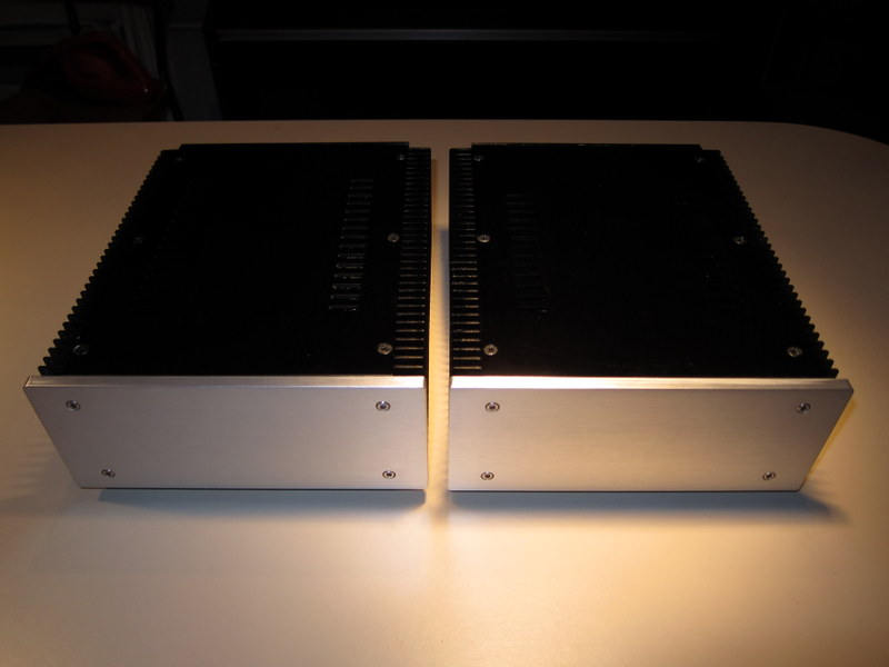

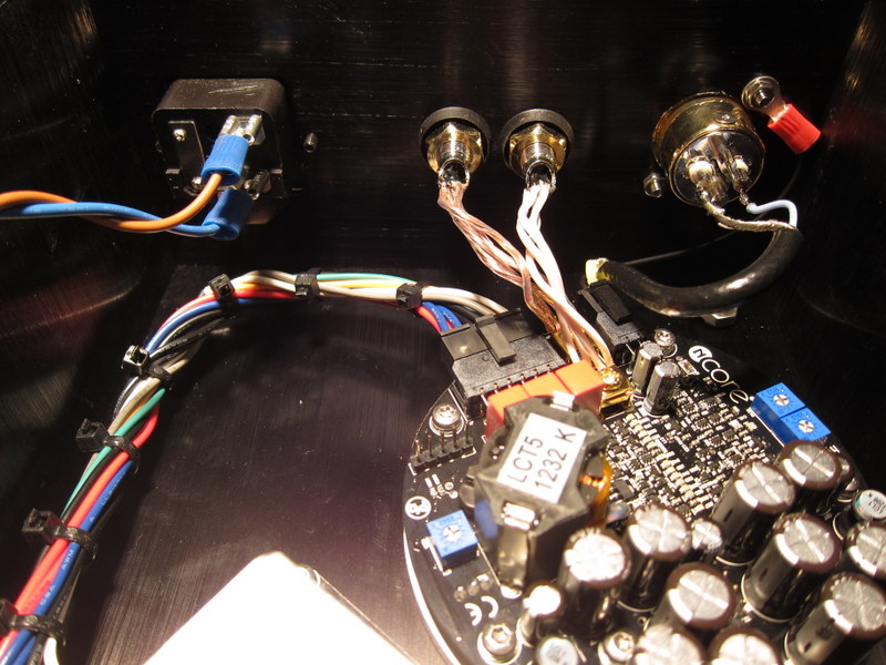

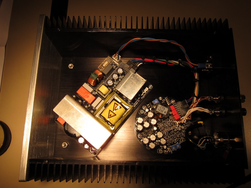

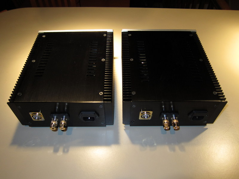

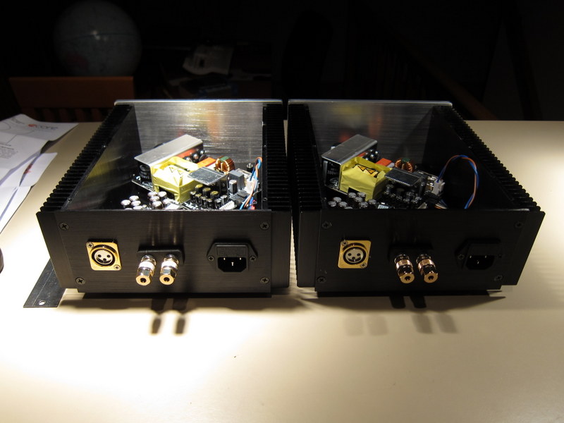

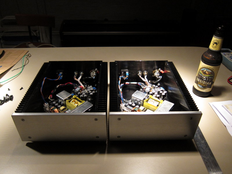

Aluminum chassis obtained from:
http://www.aliexpress.com/item/JC2109-Full-aluminum-Power-amplifier-chassis-AMP-Enclosure-case-BOX/621172993.html
Chassis includes fused IEC inlet. They have a lower-profile version that probably works just fine. I went overkill on the cooling ability just in case the room gets hot. Also, I think the fins look cool.  :D The e-tailor takes credit card and shipping is fast, albeit expensive. Total price is comparable to other options I've seen, though. The store has a good selection of chassis:
http://www.aliexpress.com/store/800514/search?SearchText=Chassis
Wire (1 ft), XLR sockets and binding posts from Handmade Electronics:
http://www.hndme.com/productcart/pc/viewPrd.asp?idproduct=1125&idcategory=145
http://www.hndme.com/productcart/pc/viewPrd.asp?idproduct=2515&idcategory=0
http://www.hndme.com/productcart/pc/viewPrd.asp?idproduct=440&idcategory=0
Binding post holes are 1/2 inch. XLR socket holes are 7/8 inch. Had to go to a specialty hardware store for the 7/8 inch drill bit as Home Depot/Lowes didn't stock it. Bought 250V/10A ceramic fuses for the IEC inlets at Fry's.
Been running the amps since October 22 and must say they sound phenomenal. The ncore trounces my Nuforce REF 9SEv3 amps w/CMA upgrade for musical realism, finesse and bass. Not bad for an $1800 BOM set of amps to soundly beat $5k+ units. I predict I will be happy with these amps for a very, very long time -- at least until Bruno comes out with something better. Cheers to Mr. Putzeys for making these available to the DIY community.
jonbee
Re: Show Us Your Core-NCore!
« Reply #334 on: 11 Nov 2012, 01:25 am »
My thoughts exactly. We should feel fortunate that for a few hours work those of us that are even a little handy can put these together as a fun, straightforward, well documented project and end up with with these stunning results.
After a couple of months I love mine, as have all who have heard it here.
The Hypex business model is very unusual, to say the least, and I wish them well.
BTW, do you fine the brand of stout shown is optimum for the amp?
