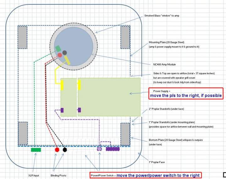

Here is "stage 2" of my build...planning the layout and a custom case.  (Stage 1 was buying the basic parts!)  I would appreciate any input everyone can offer.
I looked at all the traditional cases, and decided I wanted to do my own thing.  So, I have designed cases that will mount to the wall beside the stand holding my other gear and behind my front speakers.  There is a monoblock per speaker.
For my design - I decided to show off the core.  Read on to find out how I am going to do that.
Each has a poplar face (~12*13").  The corners will be rounded off and all edges will be rounded also.  In the location where the NC400 is, there will be a circular hole ~the same diameter as the NC400, with smoked glass covering the hole.  The module will be visible but darkened by the smoked glass.  Wooden standoffs attach to the back of the face plate to space a steel plate (28 gauge - unless someone things I should use aluminum...) about 2" behind the face plate.  The power supply & NC400 will be mounted to this, and this is also where the grounds will connect.  A bottom plate (which would be the back plate, if the units were not wall-mounted) connects to the lower standoffs to hold all the inputs/outputs.  Additional standoffs attach to the back side of the steel plate to ensure airflow between the wall and the steel plate and provide holes to mount the unit to the wall.  Air will also be able to enter the sides and flow upward & out the top (only restricted by some fabric to keep dust out).
A drawing (to scale...each grid is 10*10 mm, fyi) of the plan view follows, followed by a not-to-scale side view drawing to give you a better idea of the layout and what it will look like.  Note that the locations of the wiring runs are approximate, not exact, but the positioning of the major parts is fairly exact.
Again - any input is welcome!
http://i575.photobucket.com/albums/ss195/klinemj/planviewoflayout.jpg
http://i575.photobucket.com/albums/ss195/klinemj/sideviewoflayout.jpg
Thanks for any input!
Mark

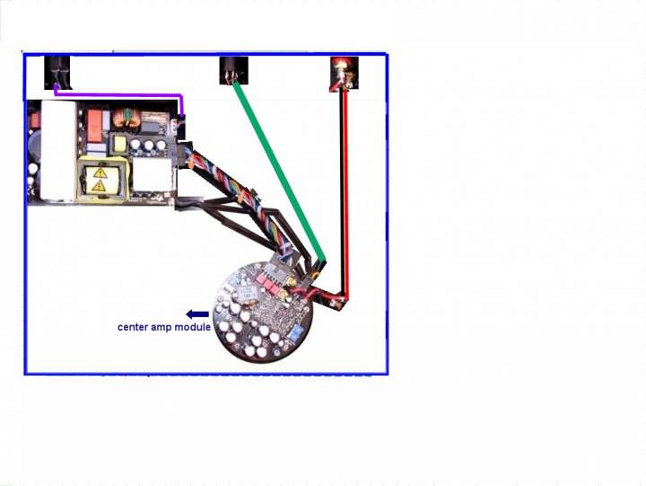

i would re-orient the amp and p/s to keep wiring away from other wiring, etc.  sorta like this; you can figure out how you want your window, but keeping wires away from each other is more important, imo:
+1  Bruno has been pretty specific about keeping the wires tightly twisted and as far apart as possible.  Check the diy audio thread, Hypex web site and the Ncore build threads here for specifics.  Great unique design idea though. :thumb:

Thanks for the input...I have been looking for aluminum thick enough to use, but so far have not found a source.  I will look more this weekend.
As I plan to lay it out, the wires will end up 20 mm apart (and twisted).  I would like to keep the "window" toward the top/center.  But, I can lengthen the top plate by ~2", rotate the power supply, move the wires further apart, and still keep the window top/center.  The revised sketch (below) shows that.  I was kind of thinking I'd like a longer one anyway...it'll be more rectangular, like my Maggie 1.7's the nCores will be driving.  (And I like the coaster idea!  I will have to look for some.  If not, I am sure my local glass supply place can cut them for me.
Thanks for the suggestions, gents!

i think you will find that the custom umbilical supplied by ncore that connects the amp w/the p/s will not be long enough to lay out the amp as you have shown in your last drawing.  if you want to have the window towards the top, i think you will be better off laying out the modules similar to what i have shown, and turn the amp clockwise 90 degrees, so that the connectors are on the left side and not on the bottom.  you may also wanna rotate the amp module itself about 45 to 90 degrees counterclockwise in relation to the p/s, to more optimally use the prowided umbilical cord length.
look at the pics shown on page 11 of this thread, which will give you an idea of the actual length of the umbilical - not sure you would wanna re-do this connector.  also, you will find a cut-n-paste layout i did, which could be easily modified to center the amp module by lengthening the speaker and input connection wires; but again, this would leave the connectors on the side of the amp, not on the bottom:
if you want the connectors on the bottom, slide everything down, (making the case larger in this direction), run the power connector up and to the far left of the case, to the side at the top of my drawing, while extending the speaker and input connectors up & to the top side...
basically, what you need to do, is rotate the p/s module 90 degrees clockwise, as shown in your last drawing...

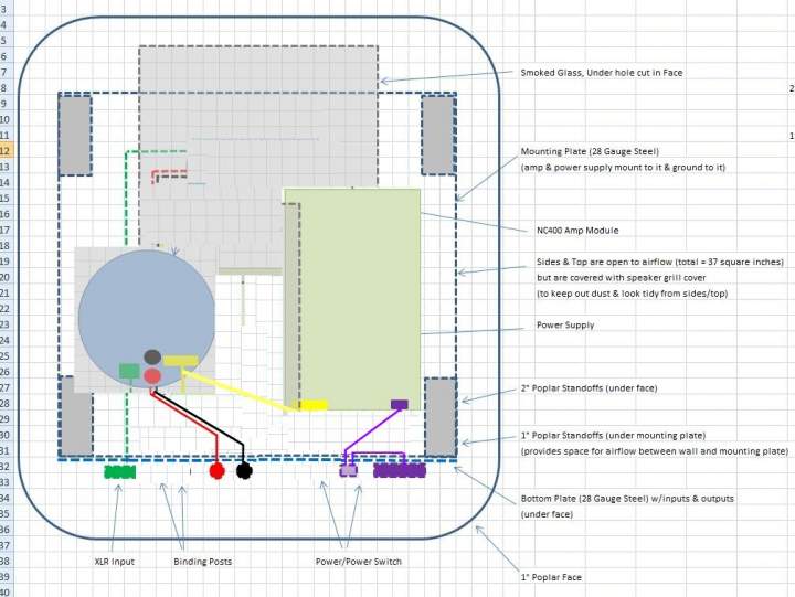

« Reply #247 on: 18 Aug 2012, 09:41 am »
The length of the provided cables was a question I had...can anyone share what the actual lengths are for the cables from the PS to the amp & power in to the PS & from amp to XLR?  That would really help as I work the final details.
I do want the plugs on the bottom - I think that will look nicer once hanging on the wall.  And, I would really like the amp module top/center.  (And if not top/center, then one top/left and the other top/right.
So, I modified it like your cut & paste.  The is essentially layout #1, but given the taller case I can position the power supply further to the right of the amp to get more room to keep the cables apart at all points.
I think the cable lengths will be fine now, but if someone can provide the actual provided cable lengths, I'll do a final check on that.  (And then, I'll start woodcutting, sanding, and finishing!)
http://i575.photobucket.com/albums/ss195/klinemj/planviewoflayoutv3.jpg
Thanks!
Mark

mark, my only suggestion now, is that you make the case a bit wider, so as to be able to slide the p/s a bit further to the right.  you can always extend the width of the case to the left, if you still want the amp module to be in the exact center.
and, (even if you don't enlarge the case), move the power wiring as far to the right as possible.

Quick question, Doug...on moving the PS and power inlet/power switch to the right...is that just to get more room between the power cables and the XLR & speaker out cables or for another reason?  Just curious.
I came up with a revised way to build the frame that ends up behind the face plate that will buy be some more room, so I will be able to move the PS a bit further away (both up/down and left/right) from the NC400 module.  Instead of using any wood in the frame, the frame will be 100% aluminum (combination of 0.75-1" extruded "L"-shaped stock and 1-2" extruded flat stock plus a thin aluminum backing plate with added support from a couple rigid flat stock ribs across the width).  As a result, the total size of the box won't increase, but the interior room will.  This will also be more durable than having the wood standoffs.  (And all 3 sides that will be visible behind the face plate will still be covered in fabric to hide the structure yet allow airflow...)
And, the total cost of the cases will be less than a pre-bought case!
Mark
Mark
yes - keep the power cables separated from the speaker and input cables.  good idea to use something w/smaller dimension inside the amp, to maximize interior room.

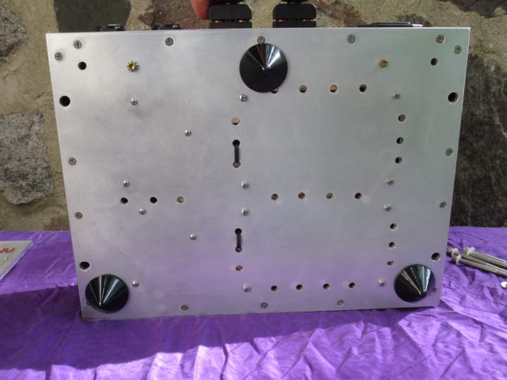

I've been listening to my NCore now for about 2 months and thought I'd share my chassis design. Top is 1/4" aluminum with hole cut and covered with 1/16" solid bronze plate. Wood is 3/4" rosewood. Bottom is 1/4" aluminum with plenty of ventilation holes.
I really like the speed and dynamics of this amp but have been reluctant to provide a detailed review yet. The amp is burned in and I'm not quite pleased with the mid range (flat) or the amount of air I'd like in the treble. I kind of concur with some others that the NCore has plenty of power and initially sounds exciting but there's something missing. Rather than dwell upon that, I'll be receiving a new Arion amp and will be able to compare the two in about a month. At that time, I'll be better able to share my experience.
My system consists of a MacMini and Oyen FW drive for music server, Zodiac Gold DAC with Voltikus power supply, and a pair of absolutely incredible LaHave Audio Mela monitor speakers. These monitors are up there with TAD monitors and are incredibly revealing. The Zodiac is also very transparent and I'll ultimately be able to tune my final system with speaker and XLR balanced cables. Right now cables are Grover Huffman.
The wiring inside the NCore I built is all 7n Neotech solid copper with teflon. The connectors on the back are one great big huge Furutech IEC, a pair of Cardas patented binding posts, and a beautiful pair of Furutech high end XLR female chassis connectors. From my experience building numerous amps using wood and 1/4" aluminum, it would be hard to build a better chassis sonically. Switch on the front is 20A from the UK.
I'll be back in about a month with some initial observations between the NCore and Arion.
