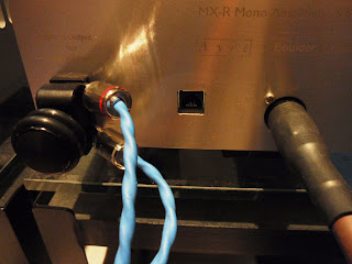

Just wondering why you didn't mount the Cardas binding posts vertically like this low profile Ayre mono amp:
Seems like it puts less stress on your speaker cables.

« Reply #232 on: 8 Aug 2012, 03:33 am »
Anand-
1)I use footers under all of my amps.
2)I've never had a stress issue you describe even with 10 gauge cables.
3)I don't see why this is specific to Cardas CPBP posts ie shouldn't others mount their non Cardas CPBP posts as you describe? I don't see that the great majority do. But anyway, the reason I chose these posts was not the sound but because of the profound clamping mechanism.
4)I think the horizontal orientation looks better to my eyes.
5) I have plenty of rear shelf space.
6) See my gallery for other designs using these posts, never have had an issue although those other designs were heavier.
7) I like to hide my cables behind my amps.
How is your build coming along?
Best,
Anand.

Anand,
Thanks for your reply.
Your point #6, is what concerns me. Light weight amps with heavy stiff speaker cables seems like a potential problem.
The amps I'm currently interested in- Ayre & Aesthetix both mount the
single knob Cardas binding posts vertically.
I'm not going to invest in a NCore build until I have a chance to compare them to
the Ayre monos and Aesthetix Atlas Signature amps.
poseidonsvoice
  • Posts: 4031
    • 2 channel/7 channel setup
Re: Show Us Your Core-NCore!
« Reply #235 on: 8 Aug 2012, 10:28 am »
Anand,
Indeed, discussions regarding this are a moot point if the NCore is not to your liking sonically.
In any case, there are ways around your conundrum, heavier chassis, etc...there is no reason to use this model of the Silicon Ray chassis, there are other options.
I have done both vertical and horizontal orientations, and it doesn't phase me to make a difference. Vertically, the cable still has to bend somewhat acutely just like in the horizontal method, as long as the amps are on a shelf. If they are not on a shelf, or on the floor, the vertical orientation can be easier. All the thicker cables I have had have been flexible, and I consider Reality Cables flexible as well, although others consider it stiff.
Best,
Anand.
