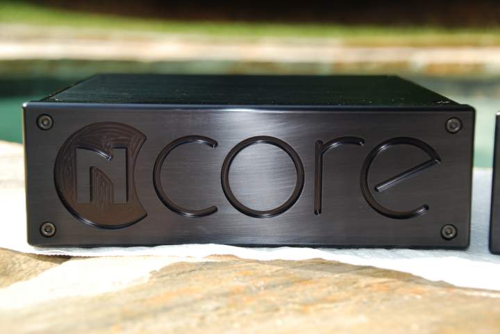

« Reply #186 on: 3 Aug 2012, 12:28 am »
Nice.
Now you just need some black SHCS for that black front panel.
« Last Edit: 3 Aug 2012, 11:05 am by jtwrace »

Jason,
Will you please stop posting that hi-res close-up of your lovely faceplate, shaming all the rest of us mere "plebs?"  :lol:
