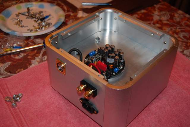

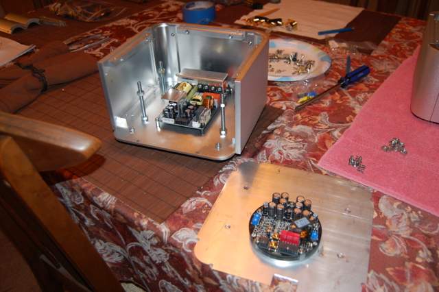

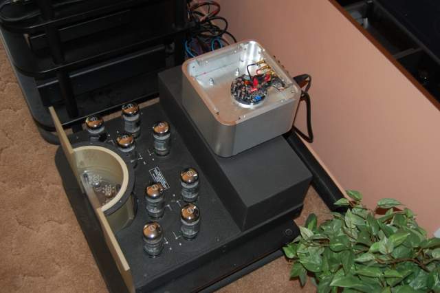

Hi folks,  just completed a couple of NC400 mono amps and thought I would share...
Quite a difference in amp technology!   Summer amps (19 watts vs 390 watts)
Take care!

Re: Show Us Your Core-NCore!
« Reply #14 on: 13 May 2012, 05:07 pm »
Thanks.
The cases are from SiliconRay via a diyAudio group buy.
Panels are 8mm thick!!  Beat-up drill press, hand jig-saw and hard work!   There is no switch because I made as few holes as possible.   No power LED.   Also, switches with a long-enough shaft are not common.
