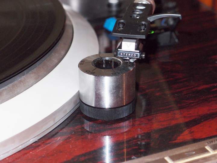

To do this, I placed the TT needle on the TT plinth to use it as a sensor and detect parasitic vibrations, feedback and footfall.... measurement.
The counterweight is used to connect plinth to arm/cartridge without things getting too awkward.

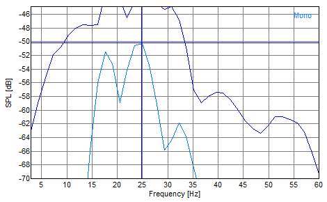

Some of my measurements:

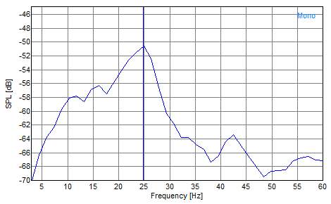

At this stage I had already placed the concrete slab and mounted it on sorbothane pads, I was still using the OEM feet on the turntable, had the lack table on spikes.
Here is a later (improved) measurement
Here the main change was the removal of the OEM TT feet - replaced with small spikes, and putting a tiny dab of plasticine under the Spike cups at the bottom of the rack.
Cost of the changes - 1 set of spikes, $15
(subsequent measurements achieved further improvements... more below!)

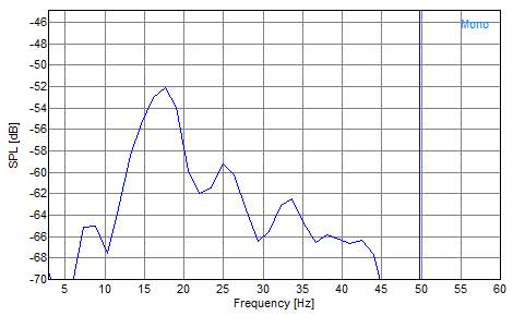

Here is one of my worst early measurements - the peak is off the chart and was recorded at around -36db
And by comparison one of my much much later starting to get there measurements:
I varied each level in my setup (floor interaction/interconnection, platform to rack, turntable to platform) individually, and swapped my various options around until each was optimised before moving to the next.
The end result was that after months of playing audio roulette and never "scoring", I worked through the whole thing in a weekend, and reduced vibration impact on the turntable by over 20db.
Now I can no longer hear my partner walking around the house through the music on the turntable (!!) - but also the imaging and soundstage remains stable, and piano notes are more solid/real.

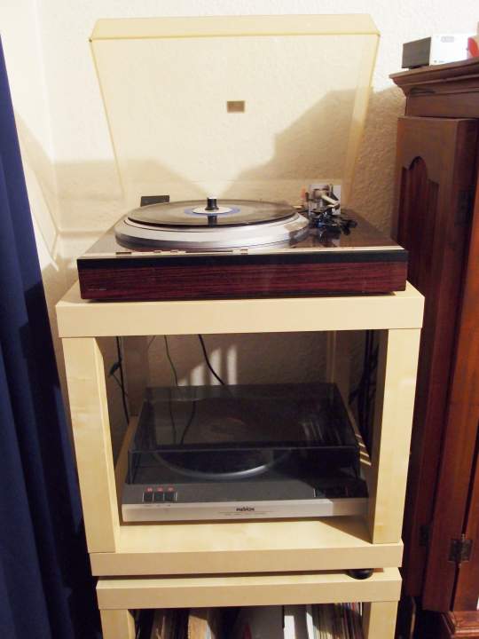

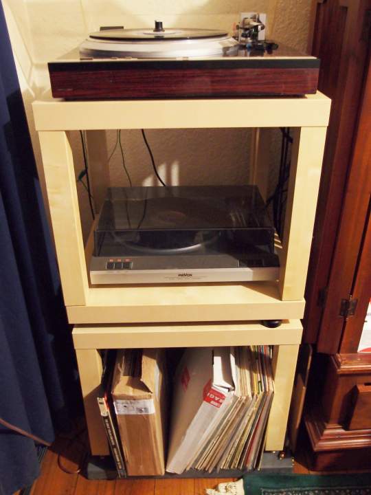

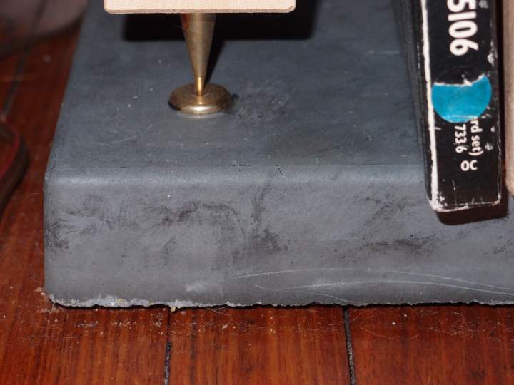

Pictures of the end result:
And working my way up...
At the bottom are four Sorbothane pads 2inch diameter rondels around 1/4 of an inch thick. (not visible in photos as hidden under the slab)
On top of these is a 36kg concrete slab, which I have wiped over with Danish wood oil to seal it and ensure I don't get concrete dust around the place.
Then come the spike cups on tiny dabs of plasticine (1/8 inch diameter sphere of plasticine flattened under each spike cup)- supporting an Ikea Lack table.
The records sitting between the legs of the rack add even more mass to the setup.
Cost of Ikea Lack Table AU$10
Cost of Spikes AU$15
Cost of Sorbothane pads AU$@25
Cost of plasticine AU$5 per 500g (negligible amount used here!)
On top of this Ikea Lack table, an Ikea Lack Tabletop (legless) is used as a platform - these are particularly good at damping mid to high frequencies - not shown here as these were not a problem area....
The Ikea Lack Tabletop sits on a set of 4 triton NeoLev Magnetic levitation feet. - These were the most expensive isolating item at around AU$200
Some calculations of expected total mass sitting on these feet was required as you don't want to go over their maximum.... once they compress down completely you might as well put spikes there!
Max per foot is 8kg
I weighed the Revox TT, the JVX TT (with the additional 3kg of damping plasticine inside it!) - and my JLTI phono stage which sits immediately behind the JVC on the top level.
I was no more than 3kg off the maximum for the 4 feet at a total of 28kg calculated.. with a bit of safety margin.
The higher the mass on the mag lev feet the lower the resonant frequency... so it is important to get the mass as close to that max limit as possible.
On top of this lack tabletop platform, in addition to the Revox Turntable, sits another complete Ikea Lack Table...
This time without spikes (yes I measured it, better results were achieved with a 1/4" sphere of plasticine under each foot to both provide some friction so it does not slide on the platform, and also a small amount of damping... plasticine damps best from 300Hz upwards, so damping influence within the problem zone being measured was negligible - but the reduction in sliding appears to have affected the 5Hz to 30Hz area where I was suffering)
Now we are at the top section of the rack:

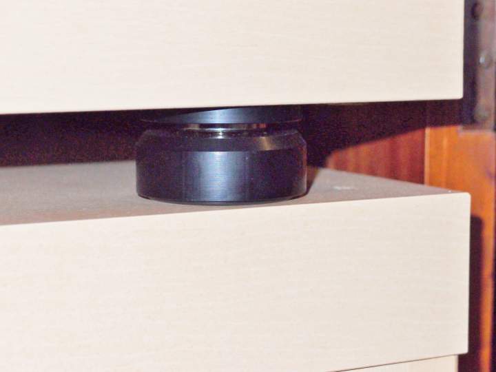

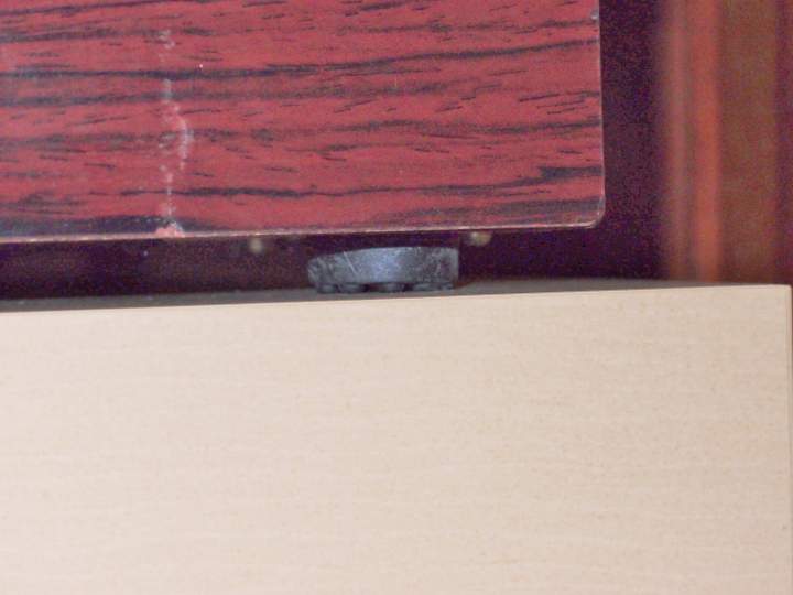

I did have the mass budget for another platform on top before the Turntable, and experimented with another lack tabletop, isolated or mounted with a range of differing feet, spikes, AS ISO9H vibration absorbers, various different sorbothane pads and sorbothane hemispheres, squash balls...
Ultimately what worked best was the removal of the OEM feet on the turntable and their replacement with AS ISO9H isolation feet...
I used 4 of these feet, the first three in a triangle - 1 at back, 2 at front, and the 4th in the centre, damping and compressing the bottom baseboard under the plinth - this 4th foot made a massive difference.
These are the ISO9H feet I used:
http://www.ebay.com.au/itm/4-Isolation-Feet-Pads-PreAmps-PowerAmps-CD-Player-/130331964175?pt=UK_Sound_Vision_Speaker_Stands_Brackets&hash=item1e5863f30f#ht_601wt_1173
Cost of ISO9H feet AU$12

Can you describe what the excitation source was and how that was set up?
What was used to measure this and produce the graphs shown?
Just looking for an idea of the actual measurement setup and technique to do this.
Tom
dlaloum
  • Posts: 710
Re: Turntable Isolating Rack - created through measurement
« Reply #2 on: 3 May 2012, 02:46 pm »
Obviously I record the turntable output with a computer (and soundcard/adc)
high quality is NOT a criteria for this recording - but high gain at the phono stage helps as the signal is very small.
A couple of years back I spent $50 for the entry level version of this software:
http://www.ymec.com/store/en/
It has seen a lot of use since.
Much of this could also be done with the built in spectrum analyser in cooledit / Adobe audition or many other recording packages including freeware ones.
The realtime analyser in the software I am using made my life relatively easy.
Excitation was via the simplest of possible methods - begin recording and take a walk around the house - this was my main problem - footfall.
With a sprung wooden floor, footsteps in the kitchen a couple of rooms away could be sensed on the plinth.
I had initially attempted to use my subwoofer to provide a more scientific controlled and repeatable source.... but footfall is down around 3Hz - and my system simply could not effectively generate anything that properly simulated the simple process of walking from my listening room to the kitchen and back.
I walked that path many many times over that weekend.
With my speakers and sub I could and did generate frequencies from around 15Hz and up (was originally seeing resonance and feedback up to around 500Hz but at much much lower levels than the problem zone) - but once the "walking" problem had been resolved, I found that the few peaks I previously had in the 30Hz to 500Hz range had dropped off to negligible level.
This was something I had hoped for and my use of sorbothane, plasticine and the ISO9H feet was aimed at a broader spectrum than my problem area between 5Hz and 30Hz... but in reality, the positive outcomes here came as a serendipitous bonus.
