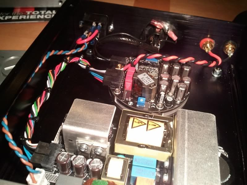

My NC400 amplifiers were assembled by someone else who decided they preferred the other amplifier they owned, and sold me their NC400 monoblocks.
I'm not sure if the grounds are hooked up correctly.
  • The AC mains come in on the left and the center pin is wired to the chassis.
  • XLR input is on the right, with PIN 1 wired to the chassis too.
  • Both wires are screwed onto the chassis at the same location.  In the picture, the location is to the right and a bit lower than where the AC mains are coming in.
Is this the right way to do this, or should something else be happening instead?
I ask because while doing some troubleshooting together, the manufacturer of another component I have asked me to use a voltmeter and attach probes to the center prong of the AC line and PIN 1 of the amplifier.  It measured 1.1 ohms, and he said that it looks like circuit ground and chassis ground are the same, and ideally they shouldn't be.

Oh wow that looks terrible. Here are my Ncore's built by JTWrace with the latest wiring. Quite a difference.

Sorry, I'm dense, I can't tell by the picture what should be happening instead.

I think the builder wasn't aware of the correct layout options and might have screwed it up.

Without getting into the above photo.  I'm not good at decoding wiring photos.
In general with balanced analog audio XLR connector's, pin #1 is connected to the chassis at the connector.  Anything much over one inch is too long. (2cm)

The AC power green Safety Ground (EGC) wire should be securely bonded (that means not soldered or attached in any way that might come loose) to the metal chassis near where the AC power enters the chassis.  The XLR jumper should be attached at the XLR connecter.  The AC power input and the signal inputs should be separated by a reasonable distance.
